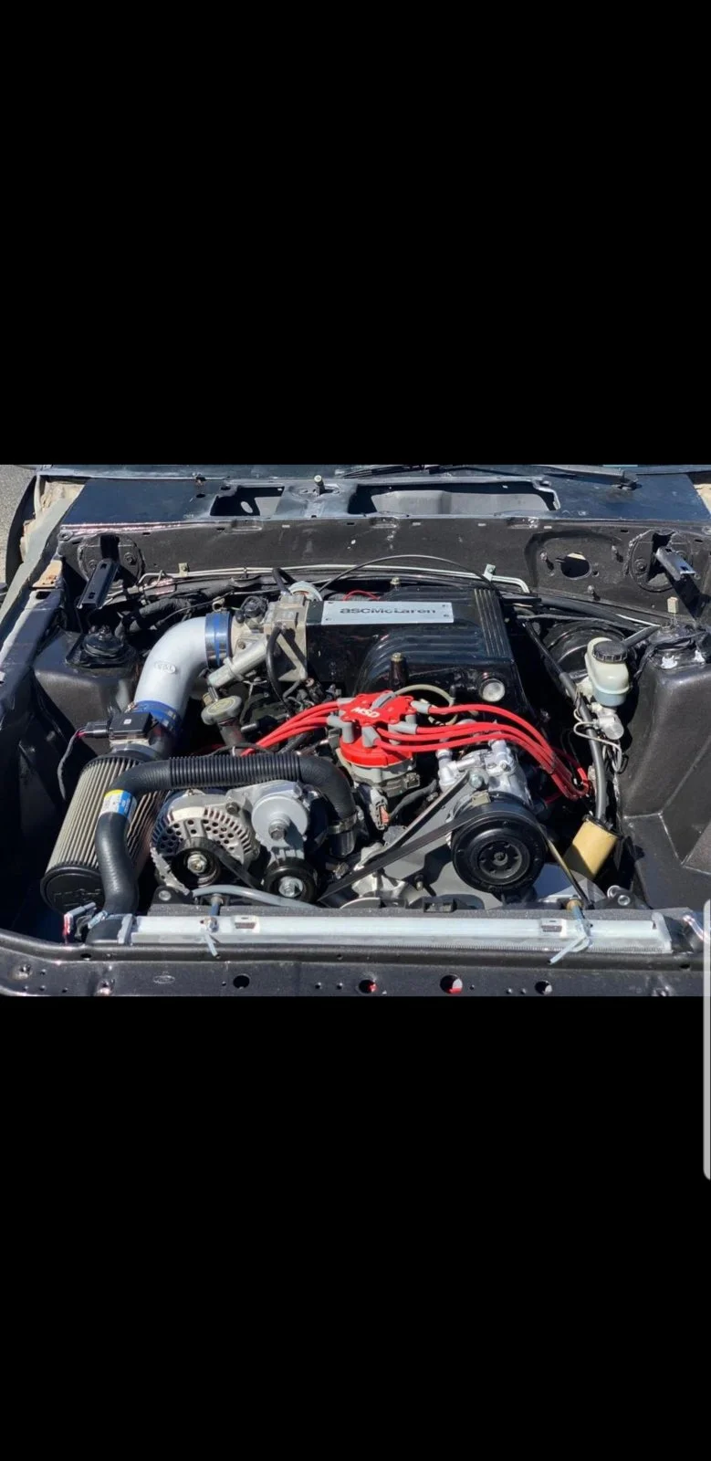

just curious, what computer is in it?
I have a a9p, some pictures of the setup. I know it may not be much but just incase.
