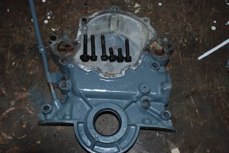

This is the timing cover that came off the engine:
The car is a 67 but the engine in it was not original so it could be a later model cover.
Can you tell if this is the "bolt on" style timing pointer cover? I'm not sure.
Thanks

You should have no trouble bolting the pointer on that cover.
Thanks
That's the bolt on cover. The pointer bolted onto that small holed boss on the 2 o'clock position just above the cover bolt hole and the other end attaches with the lower left hand cover bolt. There's a casting number somewhere on the cover, that'll tell you if it's the correct cover for a 67. It will have had a C5, C6 or a C7 prefix. But Ford also used this same basic cover with newer prefixes up into the late 70's. It used a different bolt on pointer that was attached with the lower right hand bolt holes straddling the dipstick tube.

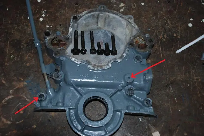

In reponse to D. Hearne, the holes you speak of it bolts to are like what is shown below?
If thats right, how/what threads into the small hole?
Sorry, the other hole is the lower driver's side bolt hole. The small screw in the pic on the Mustangs Unlimited pointer goes into the boss with the small hole you pointed to. I have a habit of referring to stuff on an engine as relates to looking at them from the driver's seat. (that's the left side of the car in my mind) Move the arrow on the left side of the pic to the opposite lowerr bolt hole and you've got both pointed out correctly for that pointer.
The small screw that comes with the pointer goes in the small hole.
