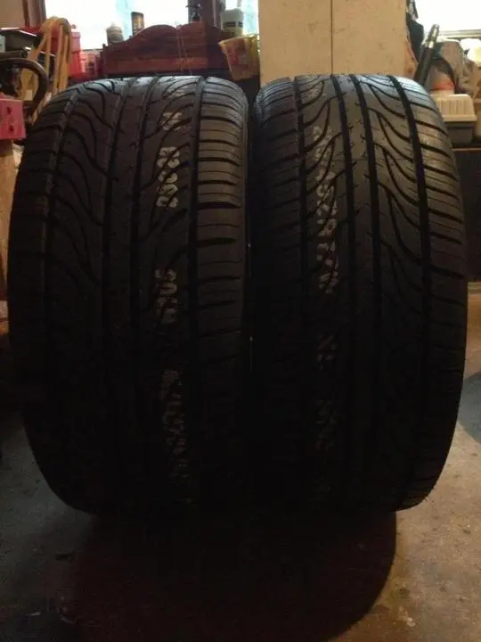

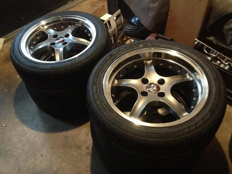

Got the tires on the rims and ready to go on the car. I had to get a special socket to get wheel locks off because I didnt get the key when I bought the car.
You can see the height comparison between the front and rear. 275/40 rear & 235/45 front.

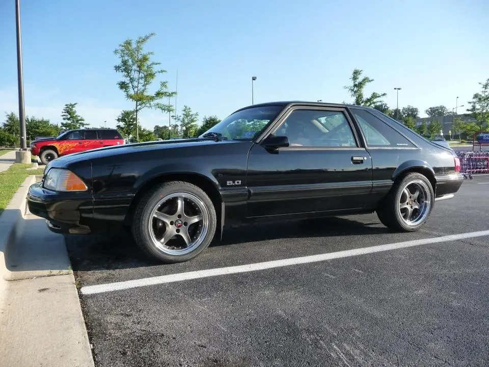

No rubbing at all. Suspension is 100% stock. Plan to drop the front a little (1.5") with BBK springs. Gonna leave the back as is. The other day I parked it on an off camber slope which stuffed the drivers side rear tire up into the wheel well. No contact there either.
