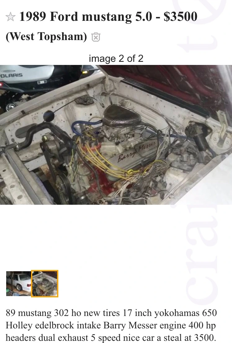

My names Nick and I'm totally new to mustangs (and v8s for that matter) coming from rotary engines and 4cyl turbo miatas. I found a post for a notch on cl and my dad already has 2 lx hatches so we figured why not buy a notch?! Both the lxs have VERY minimal work done I.e. Cat back and I converted one to an electric rad fan. This guy claims 400hp (doesn't say crank or wheel) with his carbed 302. He lists minimal mods on post and only his wife is around to speak with until I look at it. Is this a ridiculous claim? 400 crank na seems kinda tough, 400 whp is a joke. Thoughts?

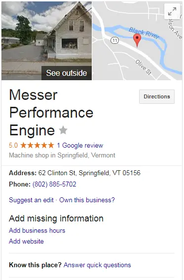

so I already called messer, he says "I don't recall a white fox, but if it still has the 302 it's not very easy to get 400 hp out of." So he put off like he would have definitely remembered if he did. Messer has a dyno at his shop too, but sadly the shop is pretty far from the car. He did remember a guy with a 302 who would get spray from him all the time, but he didn't remember the car the 302 was in.

Yeah, so chances are that it's not anywhere near 400hp. Ask for a build sheet from the previous owner.

Though it looks like a small shop, not that it makes them bad, just relatively unknown is all.

So I finally spoke with the guy, he said the engine was built, and put into the car, which was previously a 4cyl car. The owner states "I don't really know much about the car. I bought it from someone and he told me what was on it and how much it makes" so we're gunna go look at it Saturday anyway.
I'm assuming you guys are being facetious saying carb and b cam = big power, I would've never converted to carb, it could be because I'm a new school guy and I haven't messed with a carbed car, but it seems inferior in almost every way to efi. Again I apologize in advance for my almost complete lack of knowledge!
Reactions: krazedstang
The carb vrs efi debate is ongoing, most times it just seems easier to go carb, more so when dealing with a 4cyl to V8 swap
A well done swap to carb can be tasteful and perform well, look for hacked up stuff like wiring, cooling short cuts and look for brake upgrades.
Get some pics when you look at it.
It looks like a messy wiring job from pics, I'll get a good amount of pics definitely! I totally get carb vs efi when doing a motor swap, so you can pull the extra crap out and not need to worry about an ecu and junk, but I'm not sure it would be my preferred fueling option. I think I read somewhere the only diference between the 4cyl and v8 chassis is suspension and brakes, let's say the guy has no idea if they've been upgraded, how do I tell? And what would be a "cooling short cut"? Like a poorly mounted rad fan/wiring or zip ties and bubblegum holding the radiator up? Coming from the drifting community you guys should see the junk these people throw together and try to sell
Just use your common sence, molded hoses not that flexable crap, direct wired fans, that sort of thing,
Take a paper an pen and do a pros/con list. Some brake upgrades are hard to spot, if it's got at or near that many ponies the engine will sound like it. Look for aftermarket heads and stuff like that but don't just poor over the dog house, check seat pans for cracks and updated rear control arms,
And make sure the engine is cold when you get there, a warmed up engine can hide the 'cold start death rattle'.
