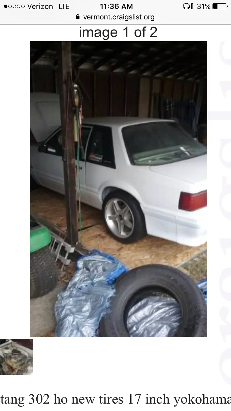

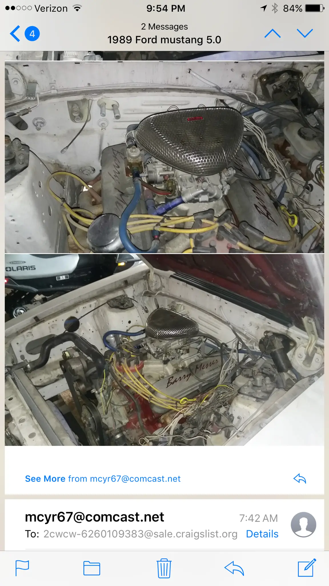

Do you have more pictures of the car?
Ramennoodles said:
Is this common rhetoric?
LOL, not rhetoric at all. A lot of people get in to these cars for different reasons. If this is the car you want then by all means go get it. You came to a forum to get our opinion about the purchase of this car and you're getting plenty of opinions and input. So far the info you've provided tells us nothing good IMO. Just looking at the one large photo you provided us tells us (or just me) a lot about the car and the work ethic of the person that owns/modified it.
For example,
1) The block was painted red and so are the cylinder heads, this tells me that there's a great chance the cylinder heads on this engine are cast iron. Can't think of any decent head for a 302 that will get you near 400 crank HP without it being aluminum. Who paints aluminum heads?
2) Spaghetti wiring job on the drivers side. Who needs that many wires for a carbed engine? Laziness
3) Underside of the hood is red, if the top is white then why didn't they just spray the bottom too? Short cut
4) I do not see a power steering pump. I'm assuming manual steering? Another short cut.
$3,500 is way too much for this car IMO unless there's about $2,500 in the glove box that comes with the car. I'm not trying to be harsh, I'm just trying to arm you with information about the car that you may purchase.

No offense taken at all, I came here to ask people who own/modify these cars cuz I know I'll get honesty. He has 2 pictures of the car, that one I showed and this one, I'm still interested in taking a look at it but I have a ton of new info I can use to make a much more well educated decision. I'm still hoping he has no idea what he's doing and will take 1250 cash lmao

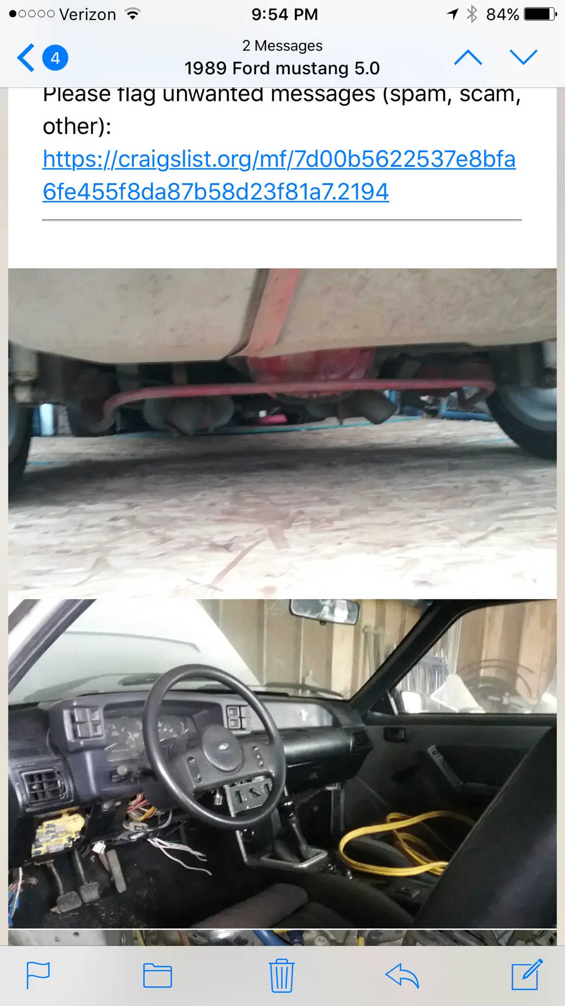

I'm in mass, we just have a house in vt so it's a nice weekend away as the excuse, but yea we're re limited for clean shells in northeast, believe me I'm in no rush to buying anything this would be a fun project to park in the garage after winter and button it all up/maybe figure out hooking up a 100 shot. I got a few more pics that solidify the shoddily done wiring lol all signs are pointing to "check it out and lowball him like crazy" also resale isn't in my vocabulary, I might have a car problem, as my gf would say, since I have 4 in the drive way... looks like a damn used car lot

I wonder if the engine is an older non-roller flat tappet 302? Can anyone help this guy out with how to identify one over the other? @90sickfox @a91what
