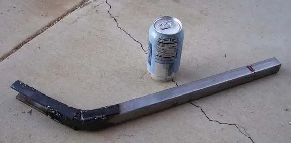

I'm just talking about your standard seal puller that you'd find at Sears or any auto parts store. You hook it under the cam, and use the other end to push down on the spring retainer until you can pop the follower out. The handle on the seal puller gives you plenty of leverage.
Here's what I used:
