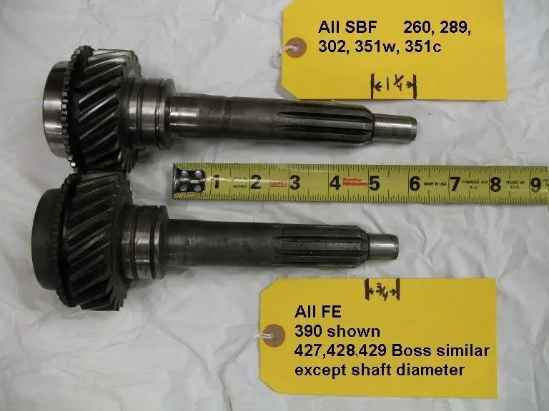

There is an additional problem with the RUG J2 that hasn't been mentioned. That is a tranny built for a 390 BBF. From the factory it will have a short input shaft--not what is needed for a small block. Here is what I am talking about:
Best to change out the input shaft for a small block one (especially for performance use), although there was a truck pilot bushing that would make up the difference. If the input shaft was changed, it needs one for a 2.78 wide ratio gearset. One for a 2.32 close ratio will not work.
Other than those 2 items, the tranny will work just fine in your 65'.

Ditto on what Dennis posted about the input shaft. It was late wne I read the first post and never looked up the numbers. You do not want to try using this transmission in a small block bell without first swapping the input shaft or using the extended pilot bushing. Been there-done that. At the very least it'll end up breaking the input bearing, at worst it'll bust the 4th gear set.

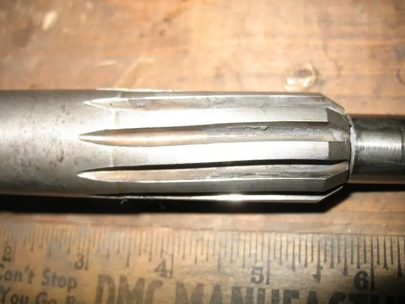

I went down this road before. Unknowingly installed a 390 tranny behind a 200 6 banger, it up shifted great, but would not downshift from 3rd to 4th whatsoever. After running it that way for about a year I tore it down to discover that I ruined both the main case (from bearing wobble) and the front of the output shaft. I lost several of those little nubs that the front C-clip needs to help hold the gear set on the main shaft.
Now when I break a toploader, it is from applying a little too much stress. Here is what I tore up last Friday at the track :
Time for a bigblock input shaft.
