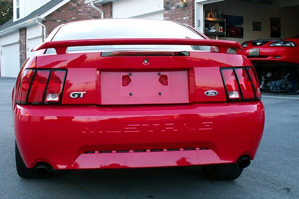

Mines in the background. I leave the rear wheels on the ground. I also have BIG jack stands. I don't trust those little ones like you have. :o
