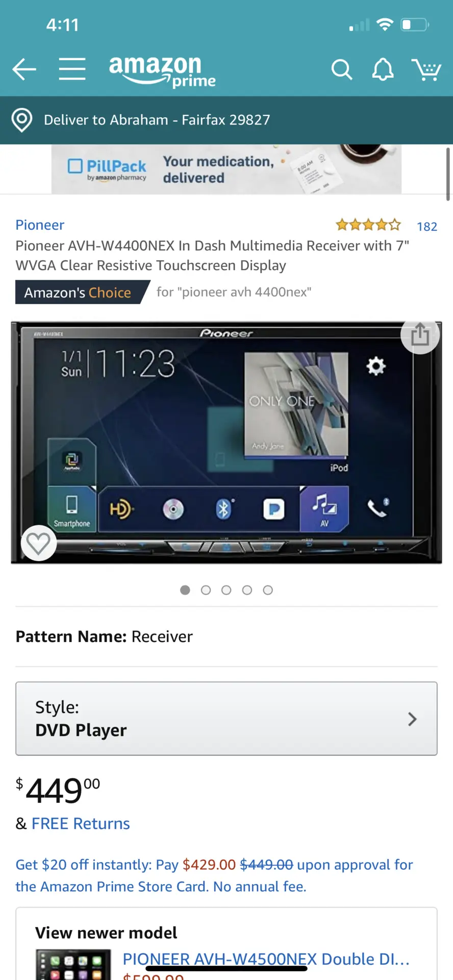

Im think about purchasing this for my fox. Before i buy it, i want to be sure it fits. Also, im not familiar with wiring stuff, id there a diagram of the wiring for the stereo to install it myself. If not I’ll take it to someone that knows.

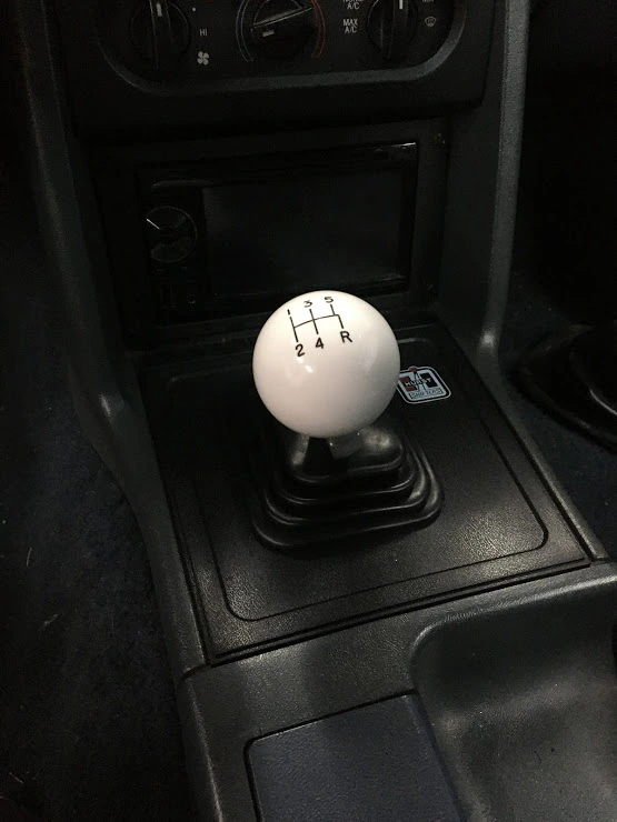

I'm not sure if that particular model fits, but I have a double din pioneer head unit similar to that one in mine. I would consider buying through crutchfield. They have amazing customer service and include installation guides and wiring adapters for free with head unit purchases. Attached is a pic of my car. It was a very tight fit, but very doable.

Love that shifter setup CheapSkate!

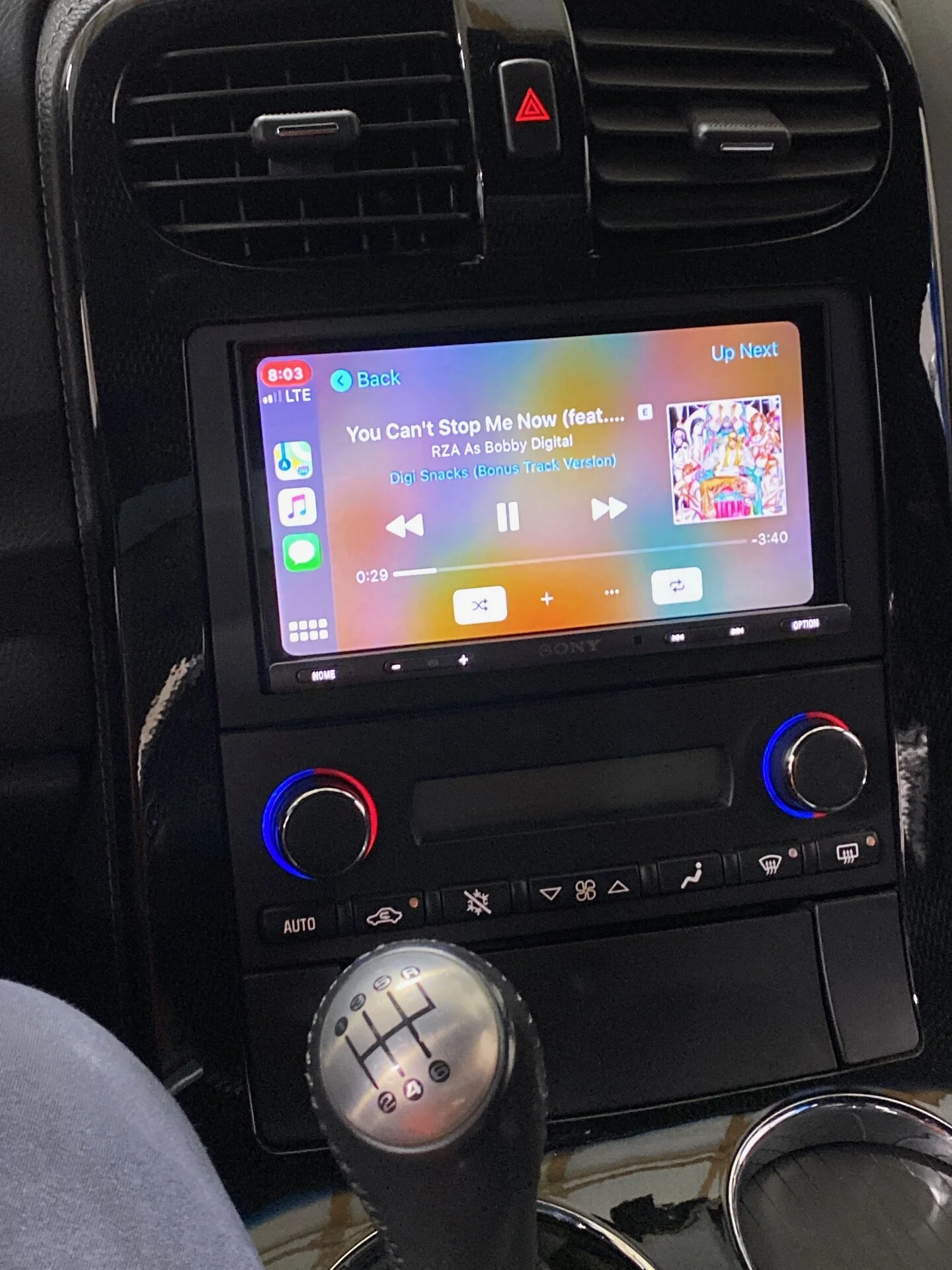

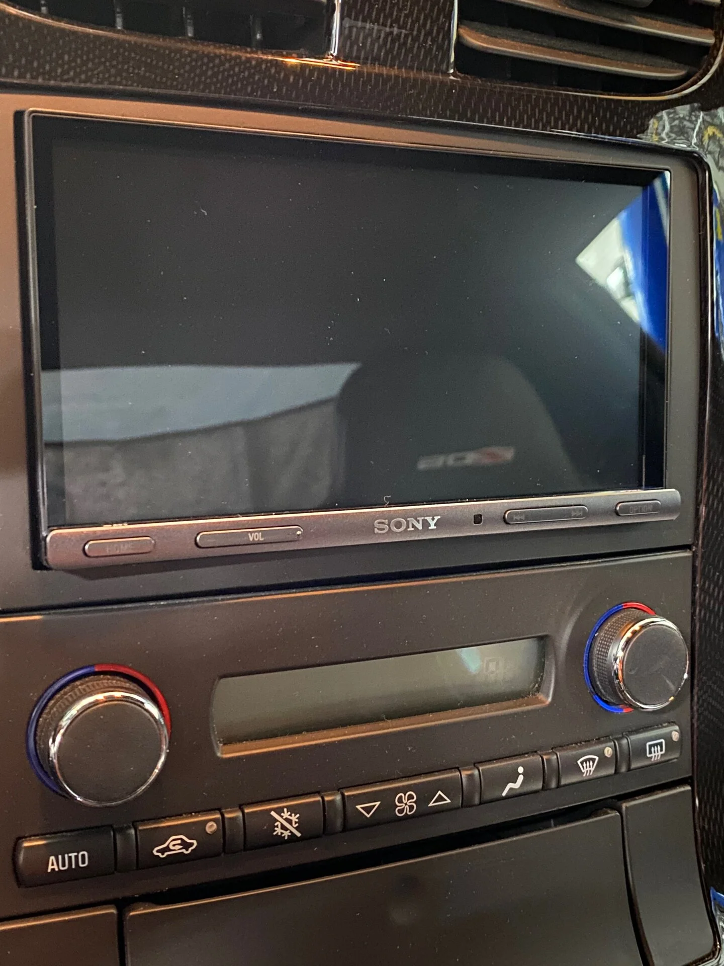

I will go ahead and throw in another +1 for crutchfield. You can even pay a nominal fee for them to connect up the harness from the head unit to the adapter so all you're connecting when you do the install is basically one plug to the car, one plug to the radio, and the antenna. They usually include a bezel if one is needed also. Crutchfield is really the only way to go when doing your own install. I just put this Sony in my corvette, it was on sale from them and they provided everything I needed. CarPlay is nice to have.

I just checked their website & they dont sell the stereo i want

Yea ^ that's how my Sony is. I really like this design, it allows all that space below to have your wiring harnesses tucked in all nice and tidy.
