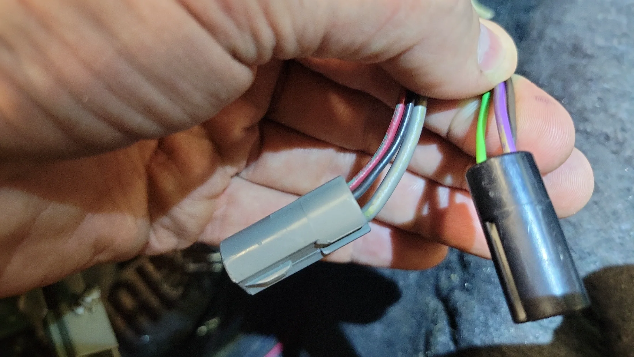

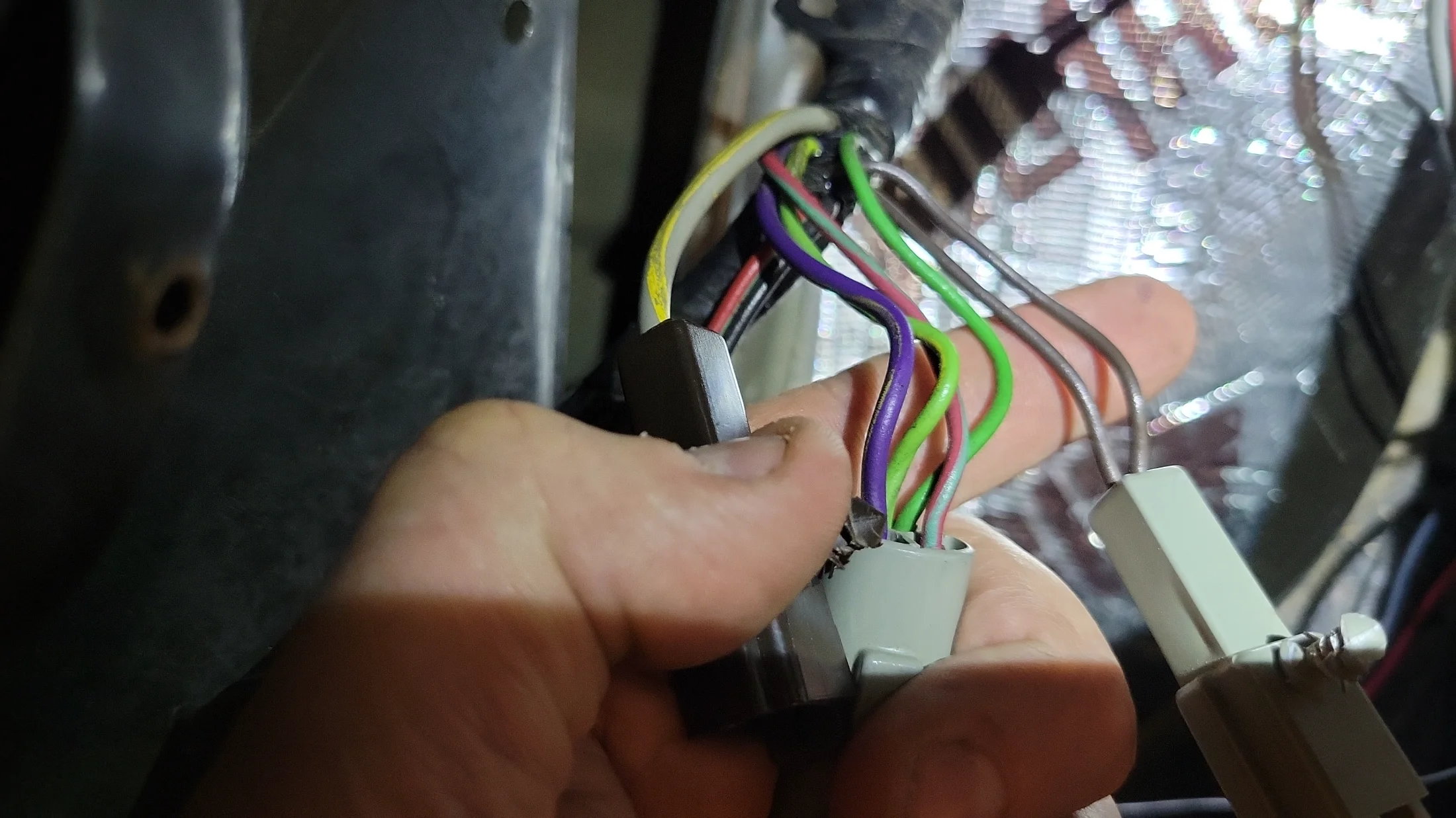

Even though they're both 1991 hatches the wires are different, and the connectors are too. I probably need to just probe this out, but its good technical fodder for future reference, and hopefully someone can just set me straight @Mustang5L5
Car side
So on Car side:
1. Double LG/Yellow
2. Red/LB (maybe LG)
3. purple/yellow
4.Grey/Yellow (thick)
5. double brown
Hatch side
1. Grey/Yellow
2. Red/LG (LB?)
3. Black
4. Purple/Yellow
5. LG
6. Brown
Also, on the hatch that came out, there were only 5 wires. So, not sure why I have an extra now.
Without probing:
grey/yellow is for defrost power. It's both the same color on each side & thicker than the rest on both sides.
Purple/green: I think this is the hatch popper, saw that in one of the wiring diagrams and there's a purple green on each side.
Red/LG to red: I think this is the third brake light, as I prematurely plugged in the connector that fit and tested it. And I saw something in one of the wiring diagrams
On the car side, that leaves me double LG/Yellow & Double Brown to figure out.
On the hatch side, I still have black, LG, and brown unmatched.
I know I should see the license plate running lights, and maybe something extra for the defrost?

Mike, appreciate the input. Your post came in right about the same time I was out in the garage testing and helped confirm what I was seeing.
Here’s where everything landed:
Wires / Functions
  • Purple/Yellow: Hatch latch switched 12V trigger
  • Brown: License plate lights parking lamp circuit
  • Red/Green: 3rd brake light
  • Gray/Yellow: Rear defrost 12V feed
Extra Wires
  • Light Green/Yellow and Black/Light Blue
    • Courtesy switch integrated into later latch not used on early setup (per Mike)
  • Double Green/Yellow car side
    • Constant hot present at hatch
    • Not used on original hatch
    • Planning to run a 12 gauge lead from this into the interior beyond the quarter panel for possible future use such as a nitrous bottle opener
Summary
All functions accounted for:
  • Latch
  • Plate lights
  • 3rd brake light
  • Defrost
Extra wiring is due to differences between early and late latch and courtesy switch setups.
Takeaway
Once you separate the required circuits from the extra provision wiring the swap is straightforward.
