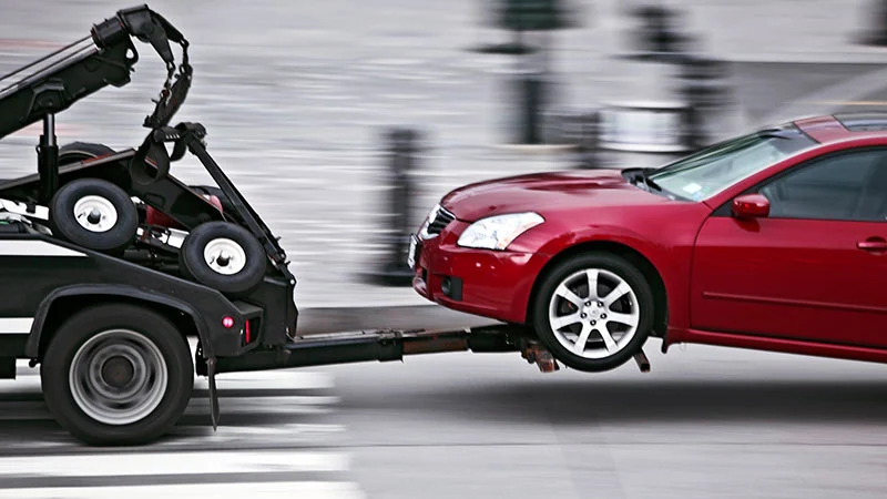

This is the style truck.
Guy was a really something... He didn't even chain the car down just hooked up the tires put it in gear and ebrake on and went

I'm hoping it is the control arms. Maybe il just get some aftermarkets. Any recommendations?
How about the cost for the test for the frame?
Should only take a good body shop 1 hours labor to measure the car out and get a good look at it. I would also contact the towing company if you believe they are at fault
