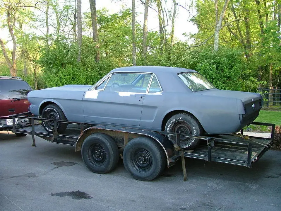

if the tow vehicle can handle it, i would 100% suggest a full trailer. that much more security, no miles added to the car (i guss they still do rack em up in neutral dont they?). just dont want anything happening to your baby.
our blazer could pull it, just not stop it. so we rented a trailblazer for the 2 hour drive.

Many of the trailers available for rent have surge (hydraulic) brakes--so no matter what car/truck you hook up to pull with, the trailer will help with braking. Trailer brakes are a must once the trailer is loaded. A tow dolly, however, may or may not have brakes--more than likely not. Go for the trailer...
