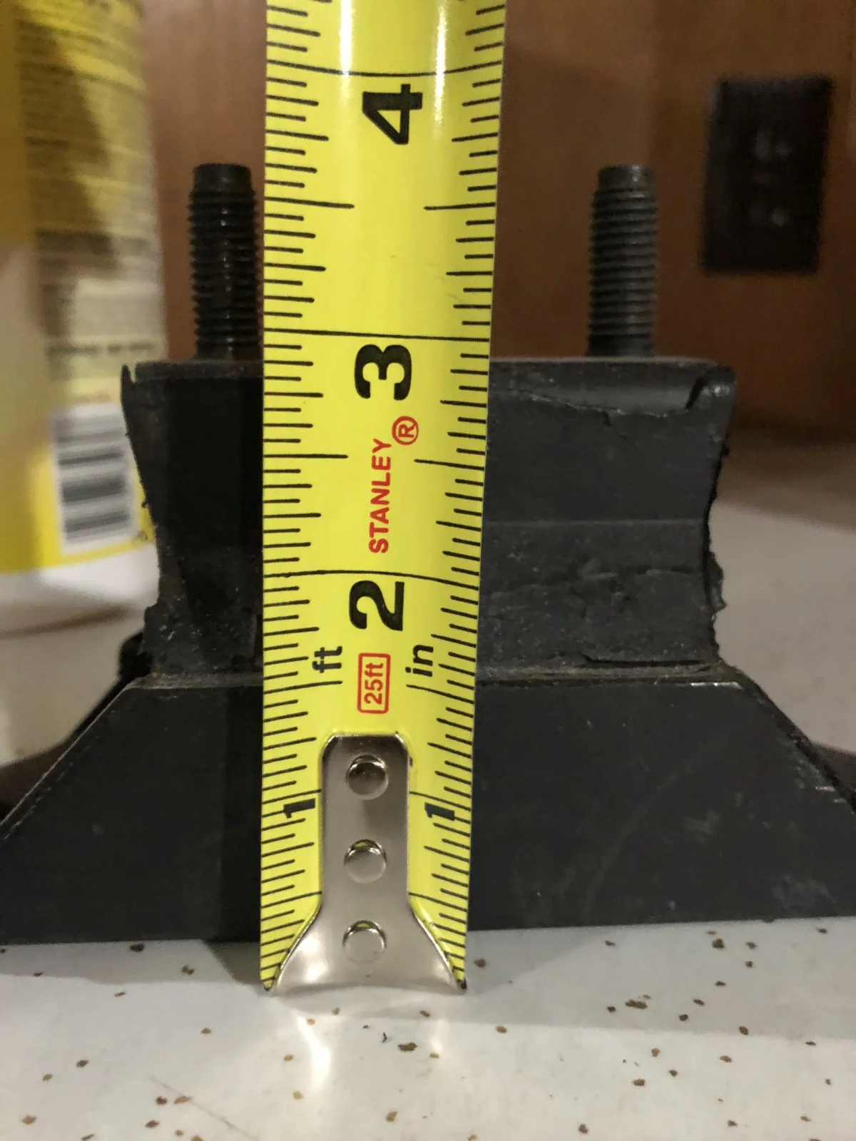

Took both mounts to work and checked them on the height gauge. The old mount is 2.404" tall. The new one is 2.776" tall. I've looked all over and can't find the correct shorter mount, and the old one is junk.

I had e-mailed Energy Suspension back in mid April and they said their mount is 2.625", and that they had no other mounts for that transmission. I was really hoping that one was what I needed. Guess when I get up, I'll pull the mount and do some pondering.

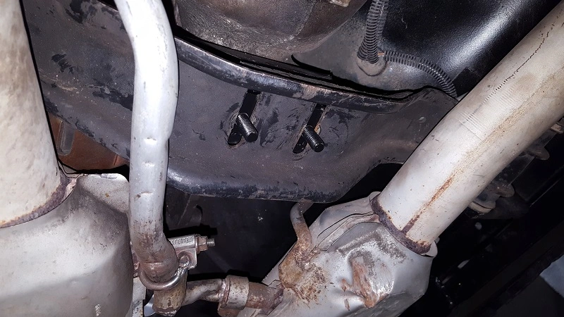

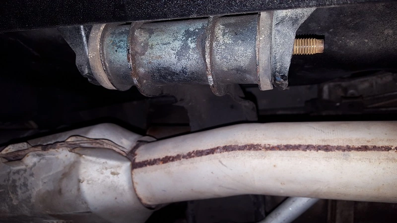

Is it possible for you to post a picture of everything like the crossmember, mount, etc? Something is not right? You said you had a problem with the exhaust hanger. What was the issue with that?

With the exhaust hanger, I couldn't get the h pipe on it with the taller mount. The pipes were hitting the crossmember. I can try to post a picture in the morning. Gotta get into work right now.

Pic of crossmember

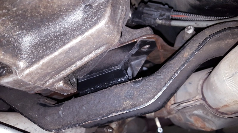

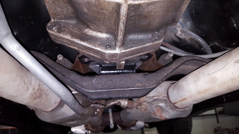

Pics as promised
I had already cut the mount down and had it welded back up to the height of the old mount, so these pics show the short mount, which is just sitting in place. After I dropped the mount in, the shifter bezel snapped right into place. Also, there's good clearance around the transmission, pipes, etc.
Something I probably should've added before, this transmission is a 1984 according to the tag, but the tail housing should be the same through the years, no?
I also heard that 79-85 had one mount, 86 had it's own and 87-93 had another. This came from an old parts book at the parts store. That got me thinking that the aftermarket companies figured the one they make now is good enough for them all. Don't really know for sure.
