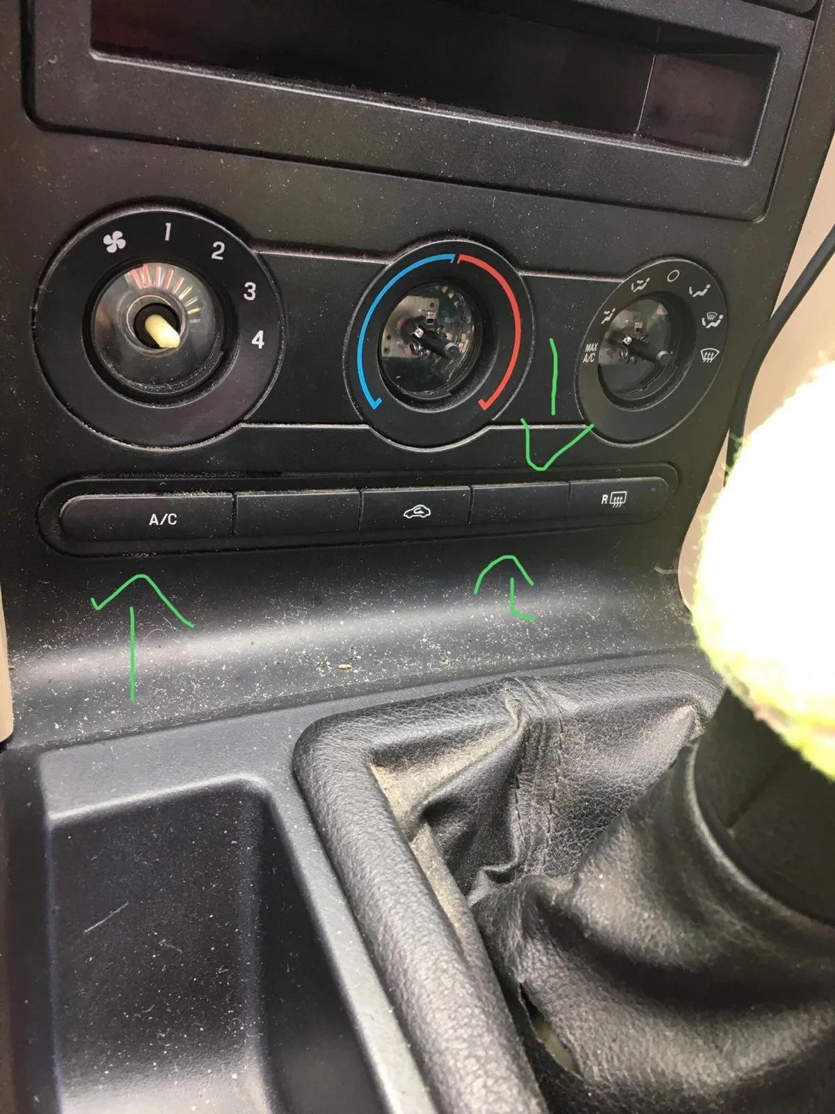

Does anyone know how to remove the trim piece around the A/C buttons.
If I remember correctly you have to pop off the side pieces (trim on either side of the center console), they are just held in with those spring post fasteners, and that should expose the screws for the radio and HVAC faceplates. I believe you just have to grip those side trim pieces and pull them back toward you.
