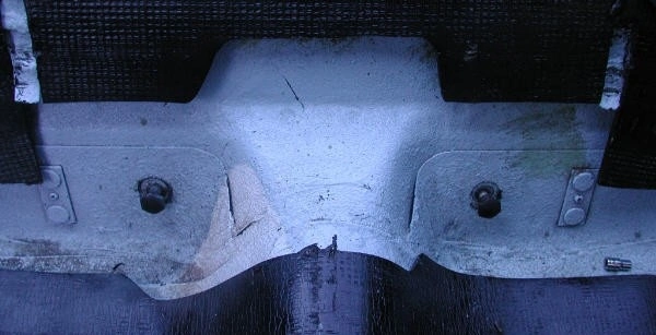

Here is a pic of what a true GT exhaust support plate & hangers look like!
The only other possibility is as the previous post mentioned, it may be a dealer GT ? I too have NEVER seen a genuine 66 GT without the support plate & hangers!
The only other possibility as mentioned, it may be a dealer GT ? I too have NEVER seen a genuine 66 GT without the support plate & hangers!
