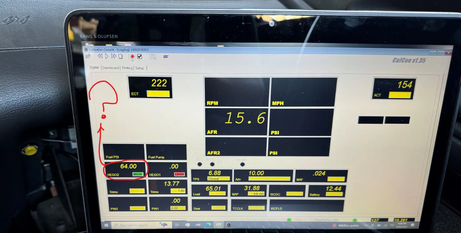

Was in the process of tuning session. On my 3rd tuning session over a 1 month period. After doing a 5 minute street drive and a 5 minute freeway drive, did a couple WOT's. Came back from my tuning drive, saved my datalog, then it was observed that HEGO2 pegged at 64 VOLTS [RICH] and stayed there ending our tuning session.
The Tuner, Mike Glover said that the prior tuning sessions showed this HEGO2 as "weak" then got better with some tweaking. But that it has progressively gotten worse until it became "dead" according to the readings on CalCon V1.35.
I attempted to swap out Driverside upstream narrowband 02 sensor with a new one, but no changes.
What should i check next?
Ideas?
