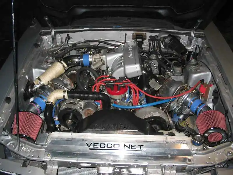

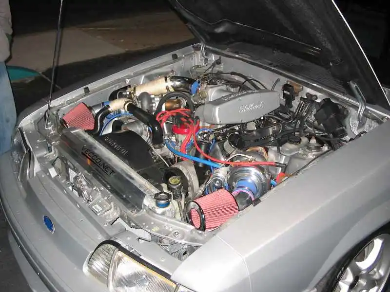

TurboCharger Question, Can I do this??? *pic* and help needed!
I've got twin T3/T04E hybrids, they work great
Hey dave, this is an off the shelf kit that is made by Vecco. ( http://vecco.net ). They are a fairly new company that is now making twin turbo kits. It only took 23 days to get the kit to my door after ordering. I have the stage 3 kit which is capable of 980 hp. It uses T3/T04E hybrid turbos. They are 57 trim with stage 3 wheels and .63 A/R. Check out their site, they have a dyno vid of an otherwise totally stock 5.0 and I highly reccomend them. PM me if you'd like more info or have any questions! :)
