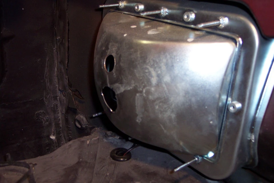

I figured that I had to add another bulb and socket to the metal housing and drilled a 1" hole to allow a 1 wire self grounding (to the metal bucket) socket and wired each one to the respective T/S wires.

The metal taillight housing w/ now two holes in it.
