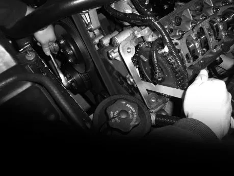

I would start by asking the person that built the engine to explain how they put the cams in properly without removing the front cover. You said that the whole motor was put together before the cams were put in: If they had the engine out of the car and ended up using something like an AFM tool I'd be pretty disappointed if I were you.
If you want to check the bolt, get a new one from Ford: It's torque-to-yield (TTY) and must be replaced every use. Don't remove the damper from the crank, just remove the old bolt. Transfer the washer over and install the new bolt. Tighten as follows:
  • tighten bolt to 66 ft-lbs
  • loosen bolt one full turn
  • tighten bolt to 37 ft-lbs
  • tighten bolt additional 90-degrees

the motor was out of the car during the cam install.. and now that i looked at pics, no pulleys were installed before hand..for some reason i ws thinking the were...so could this still be the problem?
ill also pull the bolt, get a new one and do as you said...and please excuse my ignorance but what is an AFM tool?

Anderson Ford Motorsport made/makes a tool designed to allow you to change cams on a 2V without removing the front cover. The tool basically jams the cam chains in place and prevents them from moving off the crank sprocket while the cams are out.
