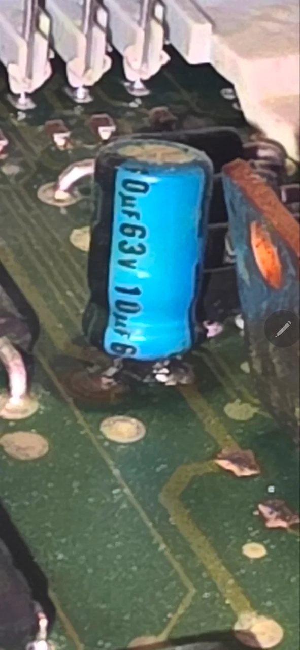

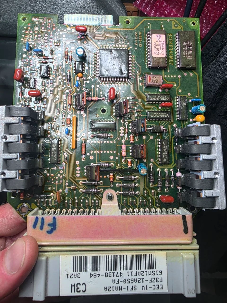

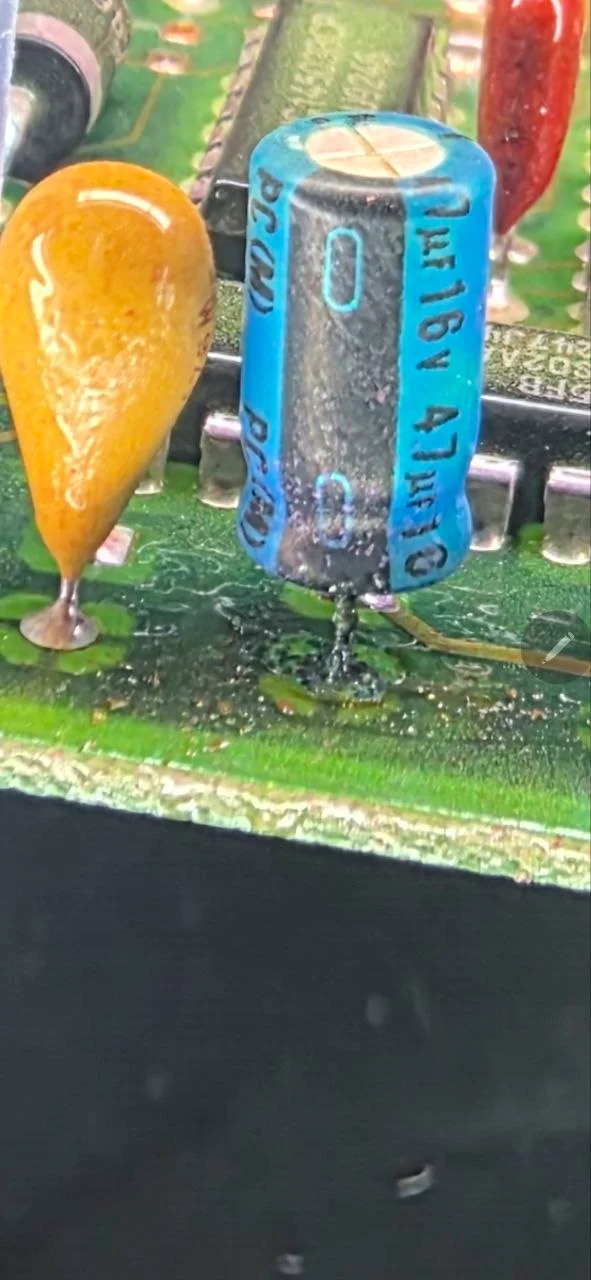

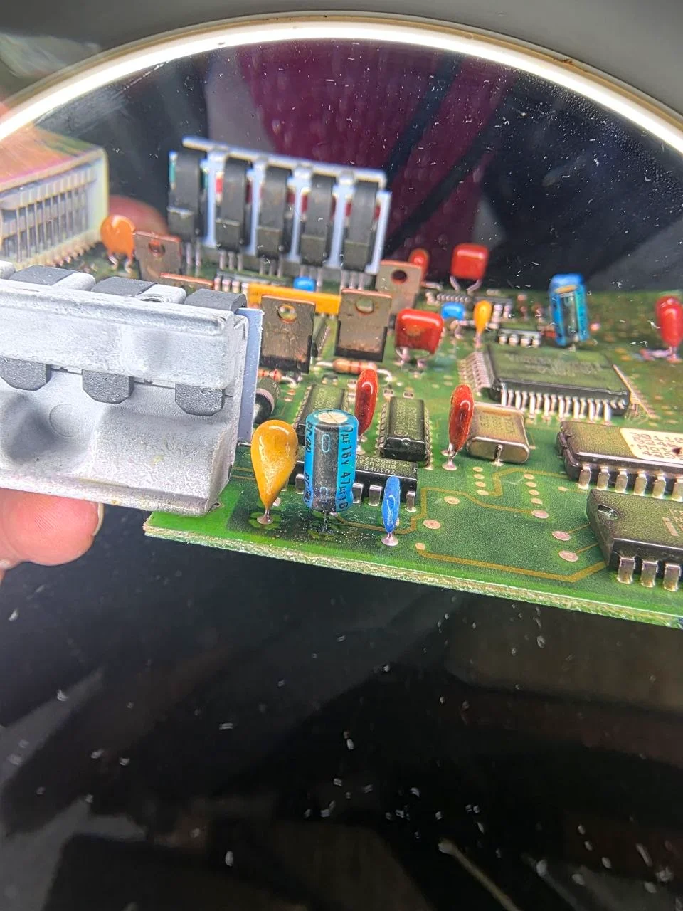

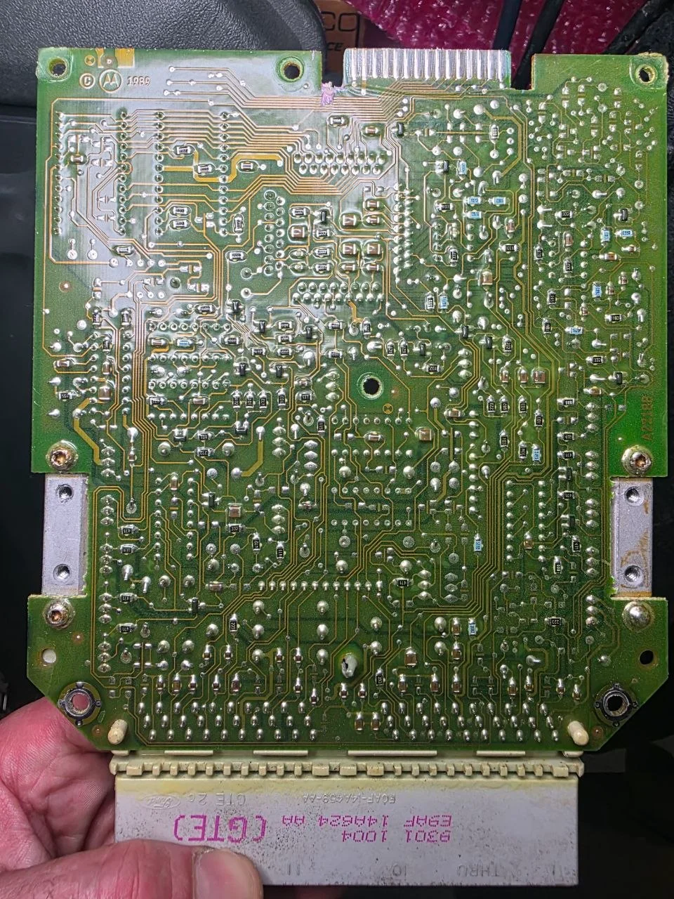

I'm having a similar problem to you I believe. My CEL comes on at times flash or stays on then goes off etc.
So after getting the codes pulled I've got a code 98. Long story short I learned something new today after being a foxbody owner for 25 years and I'm bringing my original back to life. The EEC-IV has internal components that fail from age. The capacitors leak. Corrode the PCB of the computer and cause voltage errors with the sensors or just don't allow the sensors to run at the correct voltage. I have 3 EEC-IV's that I'm going to rebuild now that I know this. I recently bought a 93GT and it came with a spare EEC. I just opened it up and checked and sure enough the caps were corroded but I had to look close with a scope to see. I'm going to rebuild the EEC-IV. It's worth opening yours up and checking if they've been replaced or not.
