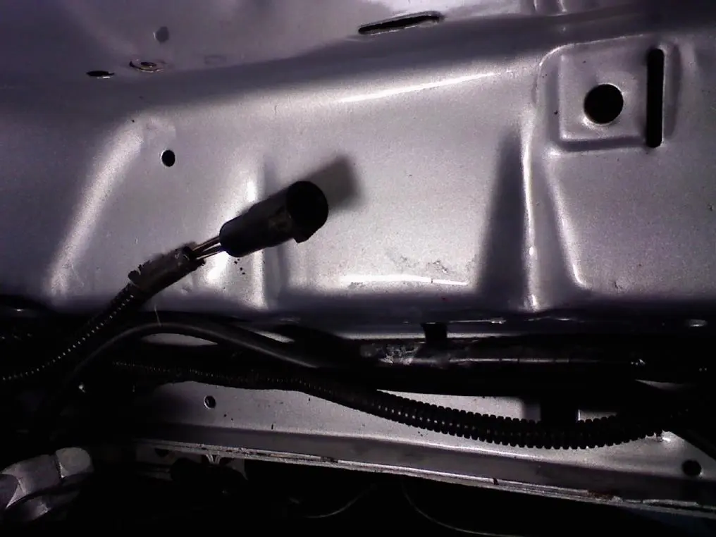

I took the battery box out this morning to see if there were any ground unhooked and this is what I found. Two black wires, 1 with a white stripe and the other had a yellow stripe. What does this plug go to?

The black/white wire is the computer power ground. It is one of the most important grounds on a EFI car.
The computer has its own dedicated power ground that comes off the ground pigtail
on the battery ground wire. Due to it's proximity to the battery, it may become
corroded by acid fumes from the battery.
In 86-90 model cars, it is a black cylinder about 2 1/2" long by 1" diameter with a black/lt green wire.
In 91-95 model cars it is a black cylinder about 2 1/2" long by 1" diameter with a black/white wire.
You'll find it up next to the starter solenoid where the wire goes into the wiring harness
Picture courtesy timewarped1972 [/b]
The black/yellow is also a ground, but I can't find what circuit is for. See http://www.autozone.com/autozone/re...geId=0900c15280069677&partId=0900c15280069537
and chase it down if you want to.
Fix the grounds first and then recheck the computer to see if it will go into diagnostic mode & dump codes.

Thank you for the detailed information. So both wires in that plug are for grounds is the way I take it?

Yes.
Spend some time with the AutoZone link I posted and check to find the black/yellow wire and what circuit it connects to.

I checked from the red/grey wire to the computer ground near the battery and it was 3 ohms-failed. I then disconnected the computer and checked between pin 46 on the computer connecter and the red/grey wire and it was .01 ohms-good. I jumpered between pins 40 and 60 and then measured between those 2 to pin 46 and it is open. I think I may have found my problem.
Also, I am pretty sure that the plug I was questioning goes to the AC Clutch Relay.
