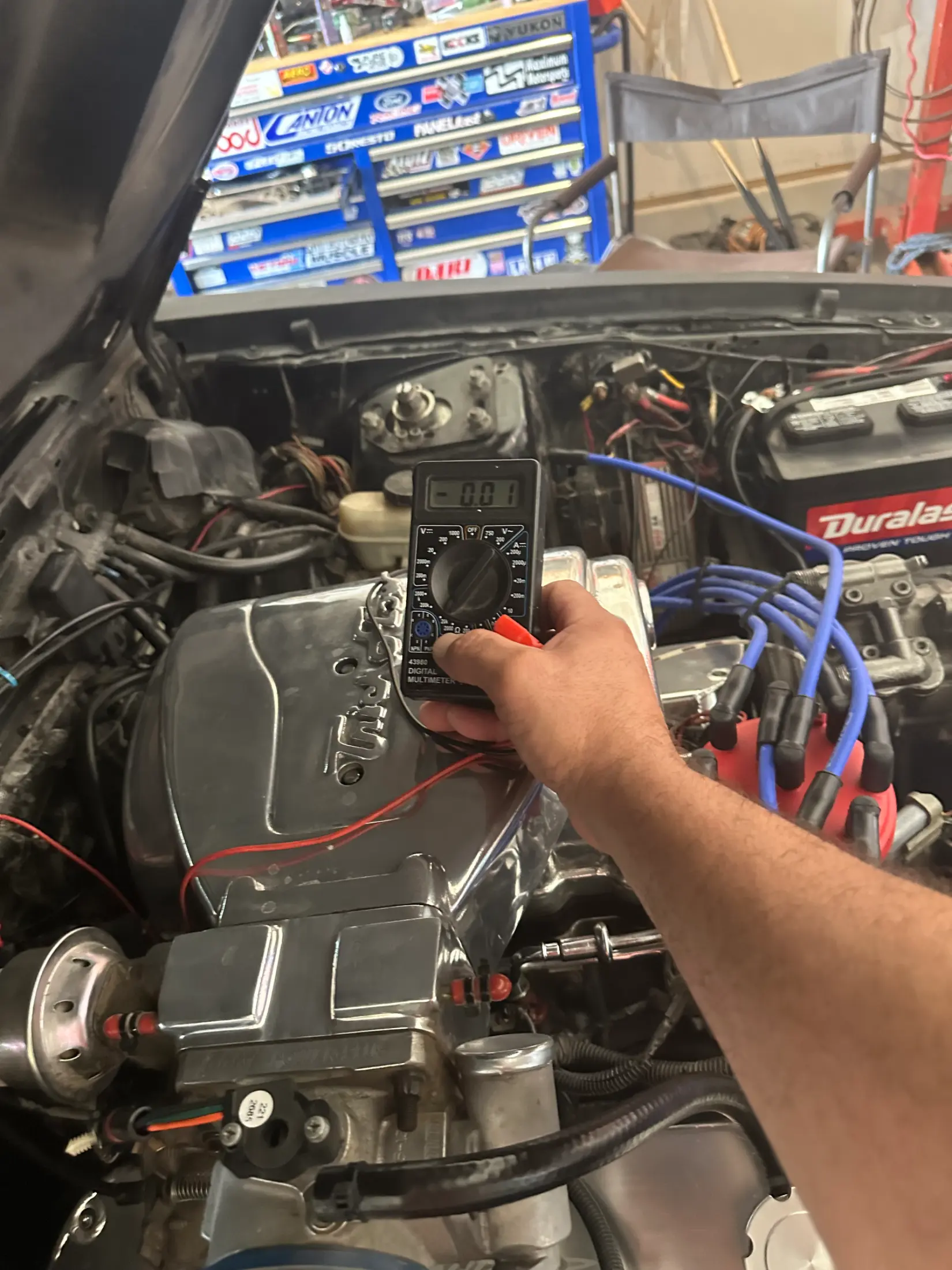

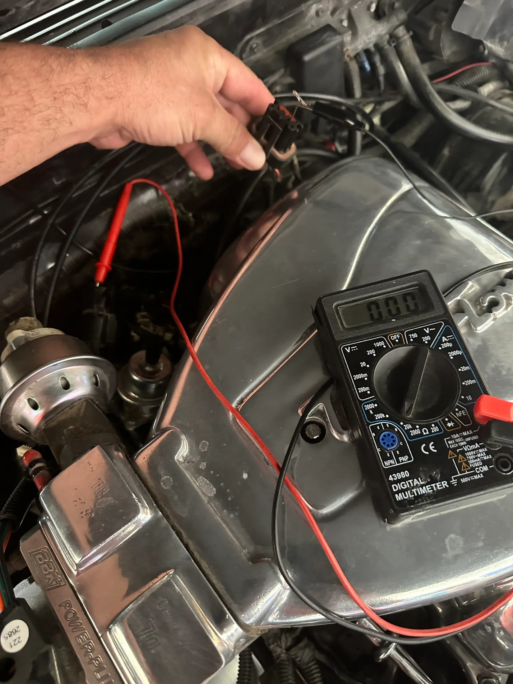

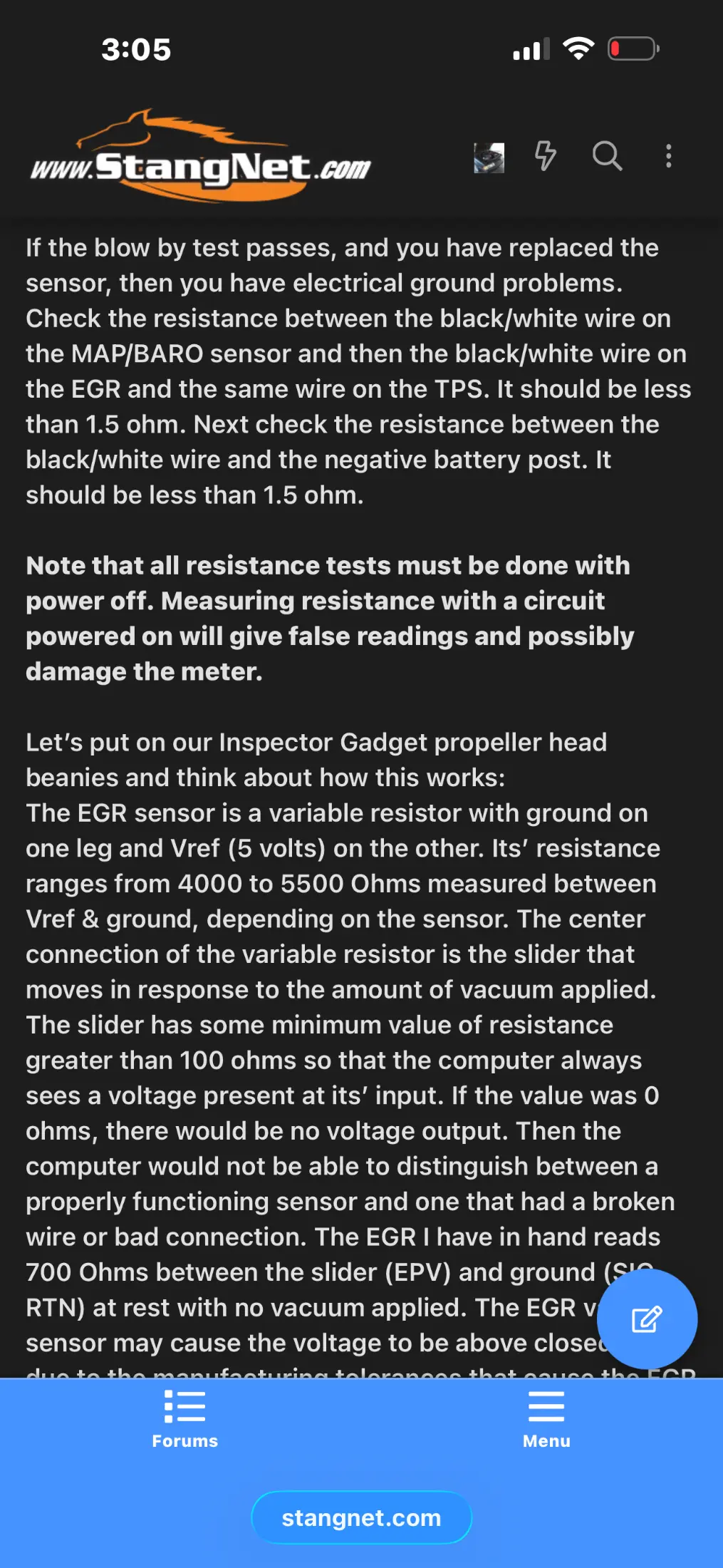

Check the wiring for resistance.
This thread is for a 92 but good info:
This thread was specifically for an 89 so the wiring diagrams are better suited for you.
Ok I tested egr it’s good now I’m at the resistance check now when I test from black /white wire from map/baro to black/white wire on the egr connector I’m getting 0.00 ohms. And when I go from same egr wire to the neg battery thermal I’m getting -0.01 what does that mean? I hmkmow I have the setting right on the voltmeter checking ohm the omega sign lowest setting I think like 20k….. actually from battery - to the map,egr,& tps it’s all -0.01 not sure if that means anything
