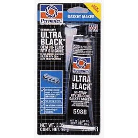

I ItsStock02 Member Aug 18, 2008 492 4 19 Westland, MI Jan 24, 2009 #6 Jan 24, 2009 #6 I used this stuff and it works great so far. Attachments 51HXPVHA7BL._SL500_AA280_.webp 14.4 KB · Views: 184

98COBRA281 10 Year Member Nov 24, 2007 1,348 30 59 Port St. Lucie, Florida Jan 24, 2009 #8 Jan 24, 2009 #8 ItsStock02 said: I used this stuff and it works great so far. View attachment 275461 Click to expand... +1 works perfect
