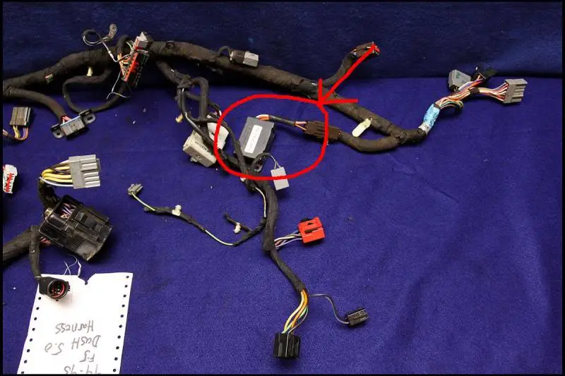

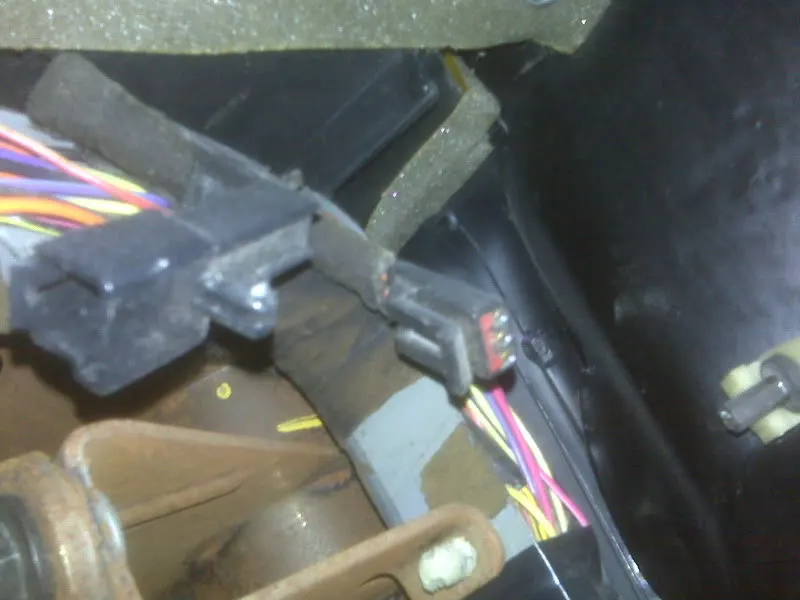

Can someone tell me where these plug into
Drivers side , on center console side

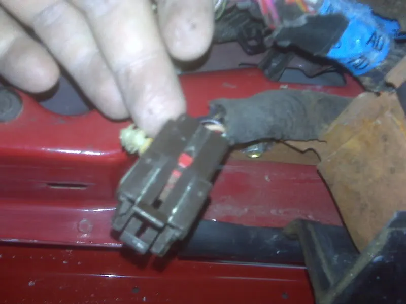

Passenger side , far end of dash comes out beside glove box hinges

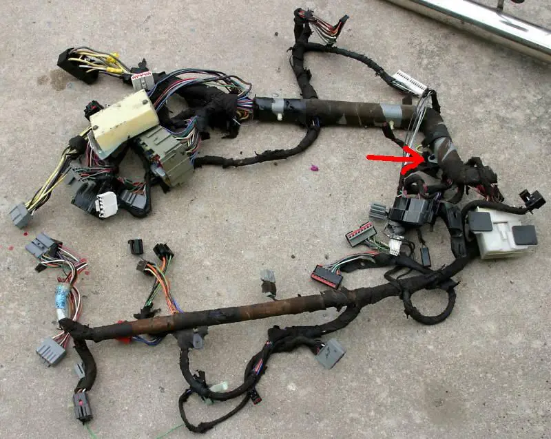

Second one goes to nothing. Used to clear airbag codes. Cant really get a good idea where the other one is...
second one in first picture ? or second picture
Second picture one has 6 wires going to it , I know there is one that is under the glove box with only 1 wire going to it that clears the airbag codes , but is there also one under the drivers side for the same thing ? and if so someone has to know where these other pigtails go , I am kinda lost , first time pulling whole dash out .....
Does the box that's plugged into the passenger side plug have F4ZF-7E453-AA on it? If so, it's the OD module for the AODE. It's a 6 pin connector with 5 pins utilized.
