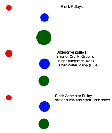

you somehow arent understanding here. You had the same belt with stock pullies. The stock pullies are smaller than the overdrives. Lets just call that the minimum belt size. You now have 3 larger pullies. Lets call this the maximum belt size. Now, you are only replacing 1 of 3 pullies back to stock size. This new belt size is bigger than the min, but less than the max. Therefor it will work.
Car RamRod
Banned
Mar 30, 2005
623
Queens, NYC
Jul 7, 2005
#17
  • Jul 7, 2005
  • #17
so look picute it like a number line. Stock you were a 1, then with all the u-drives you were a 3, and your stock belt worked for both. Now, by removing one of the u-drives your a 2. I couldnt see a feasable reason why a belt would work on the two extremes (full mod and stock) and not work in between.

You somehow aren't understanding ANYTHING. The crank pulley is smaller in underdrive pulleys. The water pump and alt are larger (larger the diameter, longer time to rotate, so slows the components down). The crank is smaller because less diameter means less mechanical effort to rotate it.
So, dropping a LARGER pulley to go back to the SMALLER stock pulley of VERY little difference means what everyone else is saying is accurate - the stock belt MAY work - if not a slightly smaller belt will be required.
EDIT: Here is a diagram I just created that shows the size variances (not to scale obviously).

Have you put the stock belt back on and looked at the tensioner? There is a range on the tensioner (Max / Min) If your stock belt falls within that zone than you are fine. If not, well just go get a shorter belt
C
criticman
Sep 7, 2003
723
Rome, GA
Jul 7, 2005
#20
  • Jul 7, 2005
  • #20
Yeah - that is what I had said I am going to try. Thanks for the tip though. Thankfully the tensioner is self adjusting...I believe based on the Haynes manual, early Fox bodies had a manually adjusted tensioner where you had to check the tension using a gauge.
