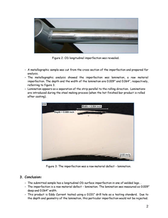

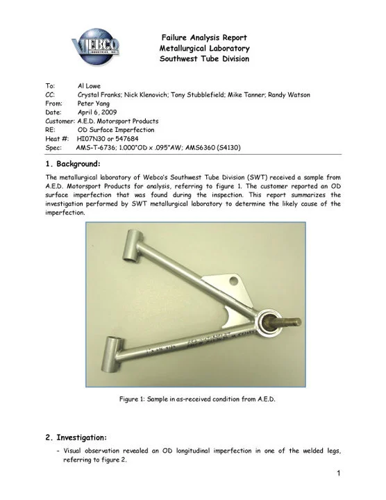

Actually it wasn't powder coating or a crack it was something called lamination. Here are the finding from that A arm in question.
Although I currently work for UPR I have been a customer of UPR for many years and if I left today I'd still run our suspension parts. Defective parts come out of every company on the market. If you only knew the number of broken suspension parts from other big companies that get brought to us at events and the shop here you would be shocked.
