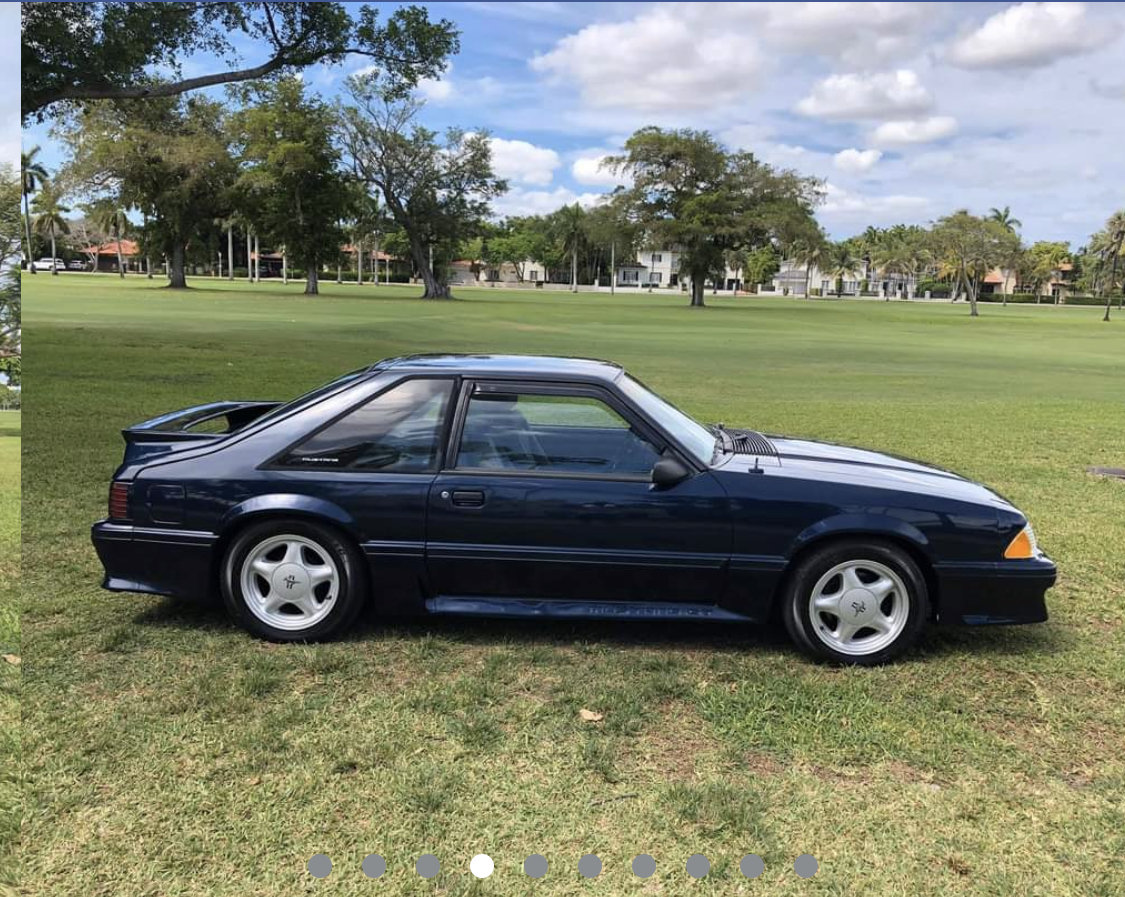

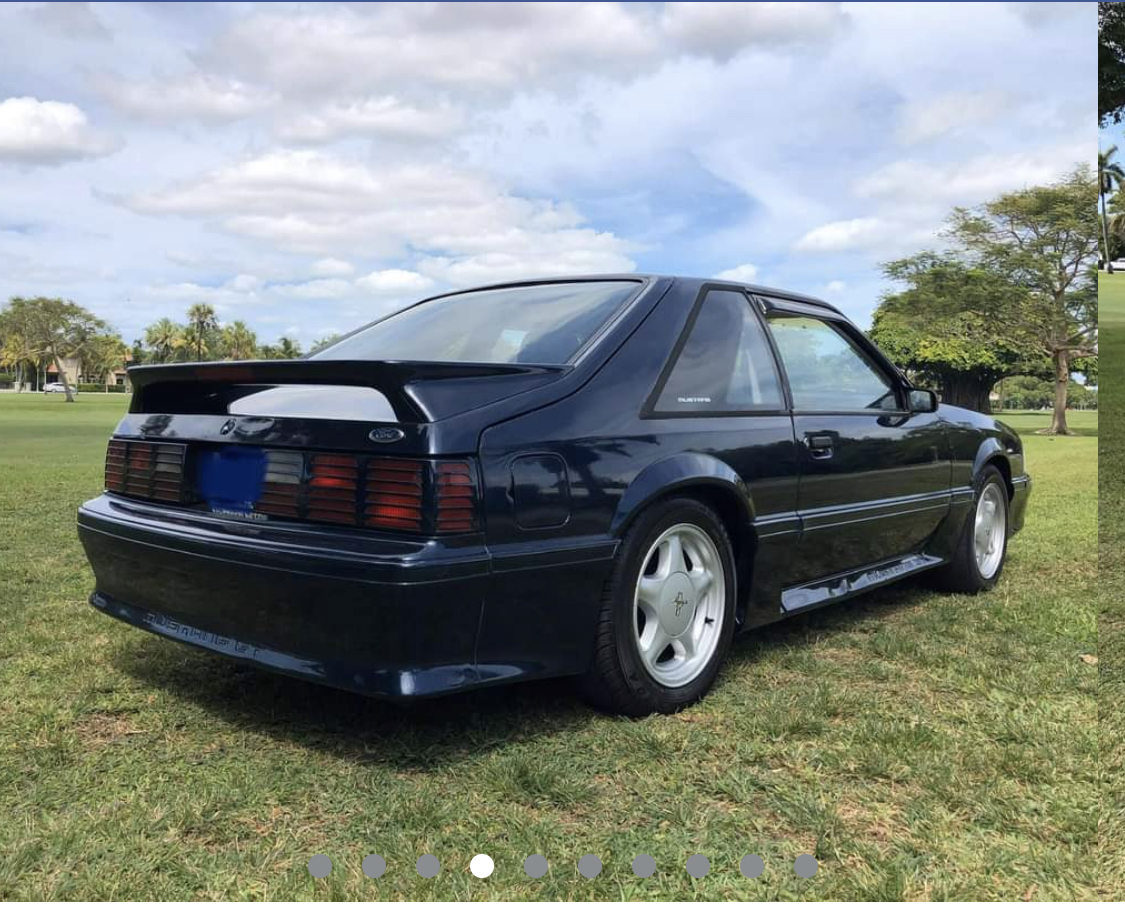

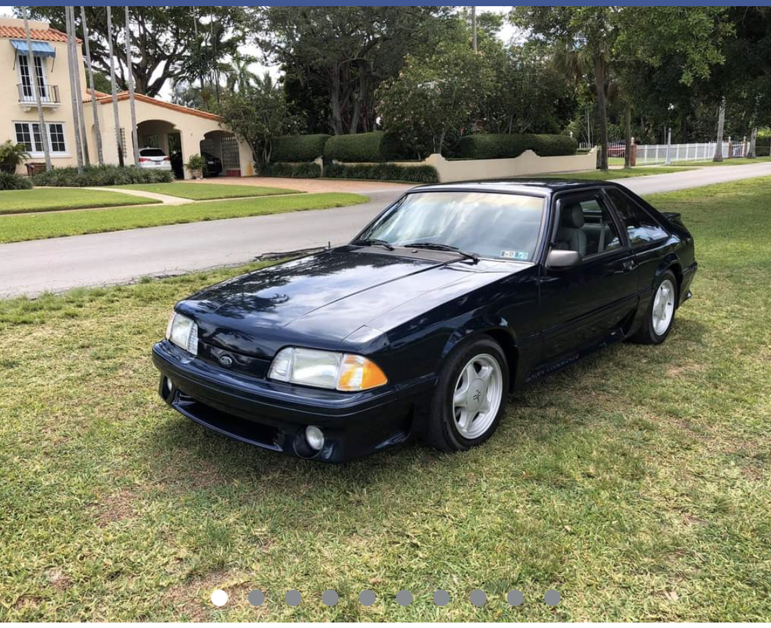

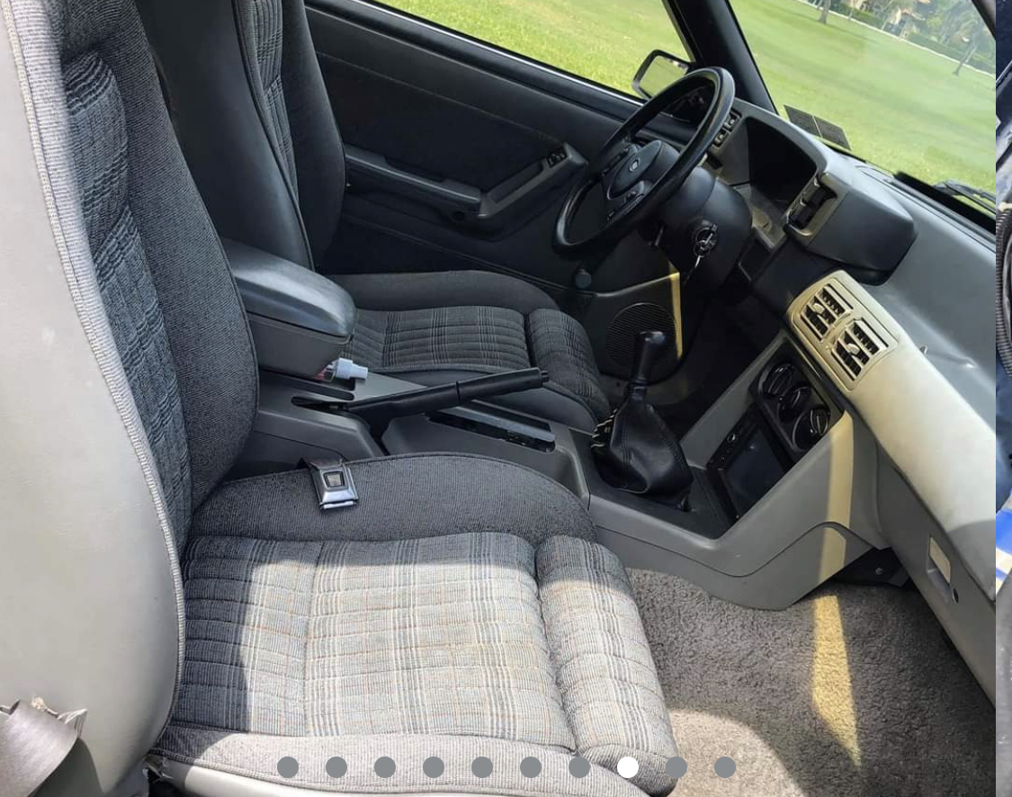

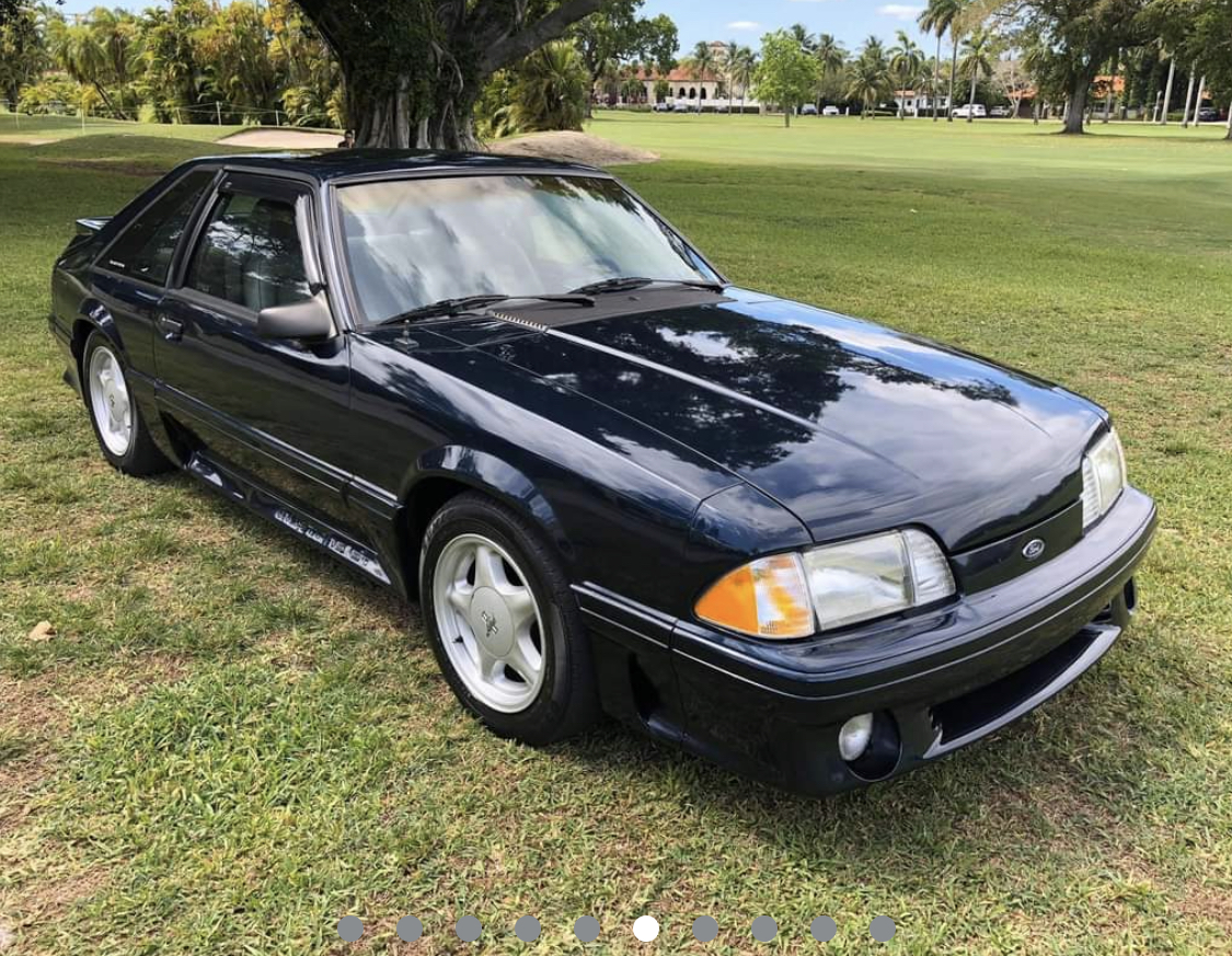

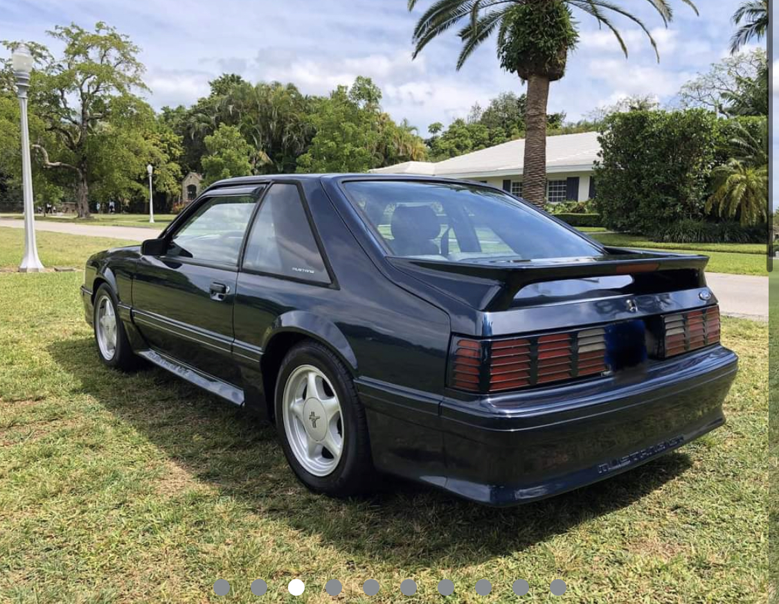

I’m looking into getting a foxbody to have as a project car and was wondering what you guys think about this one. Does anything stick out to you I don’t want anything with a lot of problems.

I don't see anything wrong with it. Looks great from the pics.
Very uncommon "No-option" GT although it does have air-conditioning. What year is it? No dash emblem and lack of mass air meter tells me it's an 87-88, however it has a 140MPH speedometer in it, which didn't appear until mid 1989. SO it's possible the mileage on the speedo is not accurate.

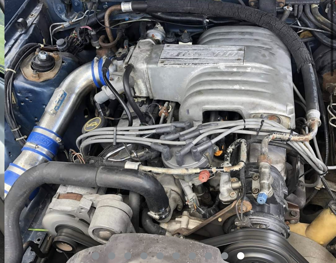

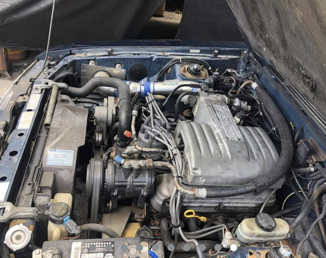

Engine looks stock other than the BBK cold air intake. A/C looks like it was converted to R134a at some time. Who knows if it's works.
Looks like a great car. I'd park it in my driveway. I'd ditch the BBK and put a stock airbox back in and work to just clean it up and enjoy it.
Reactions: Gs1987GT

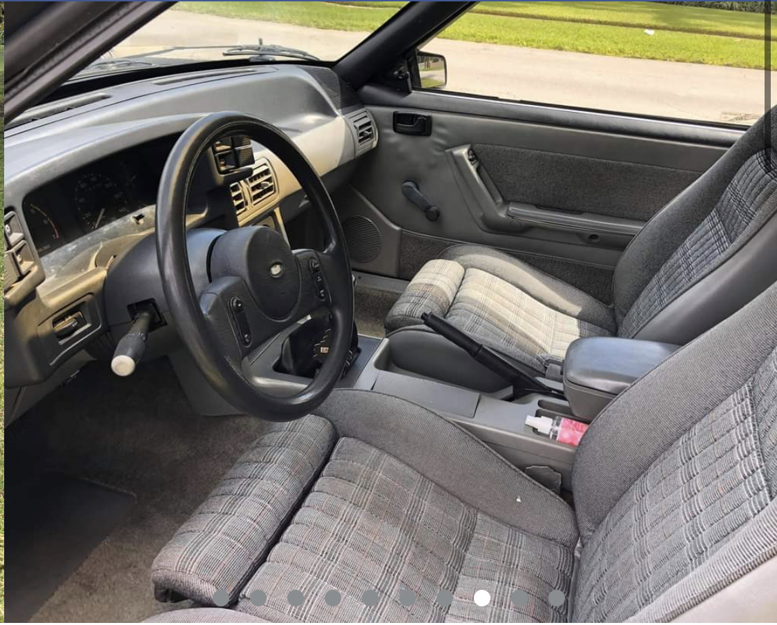

No. It is a factory speedometer out of an 1989. In 1990 the cluster shape changed, so a common mod on 87-88 cars originally equipped with the 85MPH speedo is to swap in a 1989 140MPH speedo.
SOme people match the miles to the original cluster, most do not. So keep in mind the displayed mileage may not be accurate. See if the owner has paperwork on the speedo swap, unless the mileage doesn't matter to you.
Reactions: Shakerhood
I would say check the idle for smoothness. Seems one of the # one problem on here is erratic idle. Bad idle can open the door too the checklist . You dont want to deal with the no start checklist.
Reactions: 2Blue2
If the idle is smooth, it runs well, and rust is not an issue, then look for missing smog equipment (cats and the air pump are the big, obvious pieces) and hack job wiring under the hood and dash. Also check the spare tire well for rust and the jack. See if the shocks and struts are leaking or are bouncy and if the power locks work and he the weatherstripping is.
We can only do so much inspection for you from the pictures. If you are new to Mustangs or are not confident in your automotive diagnostic skills, do you have a shop you can trust to do an inspection?
Reactions: Gs1987GT
I think I see the stock exhaust headers in the last pic. So possibly stock exhaust too. Passenger door panel by the opener has damage (not a big issue but would bug me).
The car looks really nice, to be honest. The only problem is that none of the pictures are of the common rust areas so it is hard to say...
Strut towers, door hinge area on the unibody, rear subframes, and the cowl are all need to be closely inspected for rust. It can be repaired, but rust repair can get very expensive and/or very time consuming.
If the body is clean and rust free, the rest of these cars are pretty easy to work on and I wouldn’t be too worried about getting it fixed.
