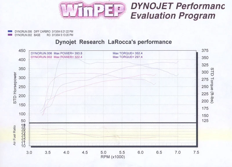

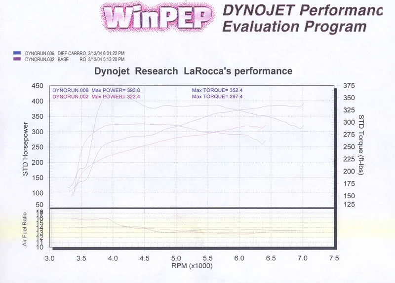

Hey Nick,
I was scoping your website :nice: and noticed you've dynoed your 408C. Would you care to post torque/horsepower vs. rpm by thousands?
You mean like this?
Or this?
Yes I have a 3k stall in the motor. Its also an Auto....so you have to start with the car in 3rd for the 1:1 ratio.....with a chassis dyno you ussually always see the charts start up above 2500 or so....at least in my expereince anyway ;)
