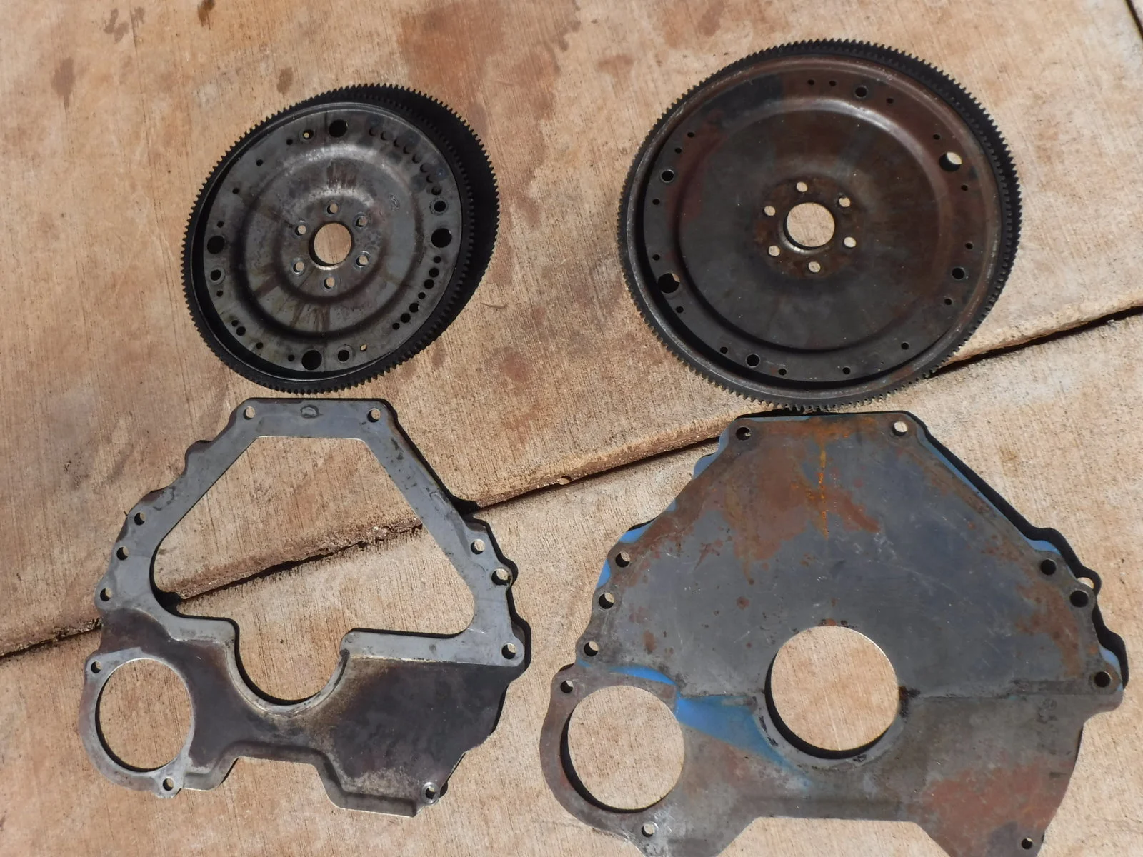

Automatic stuff but you get the idea
I thought this picture useful.
141 tooth M2 Flex plate by 1966 ~ 289 ~ 157 tooth flex plate. Both 6 bolt bell housing.
Notice how starter is tucked in on smaller block plate.
Look close for part numbers. Bell~BE-D5ZP-7976-AA, Block Plate~D5ZE-6A373-AB, Flex plate D5ZZ-6375-A (this one hard to read)
Also no '6 bolt hole' ring under Flex plate mounting bolts like on 65-66 mustangs with C4

@ LILCBRA...I saw your video and I noticed that I have the flywheel ,but a few teeth are damaged:(
@2Blue2 ...thanks for the pictures but i am installing a t5 Trans.
