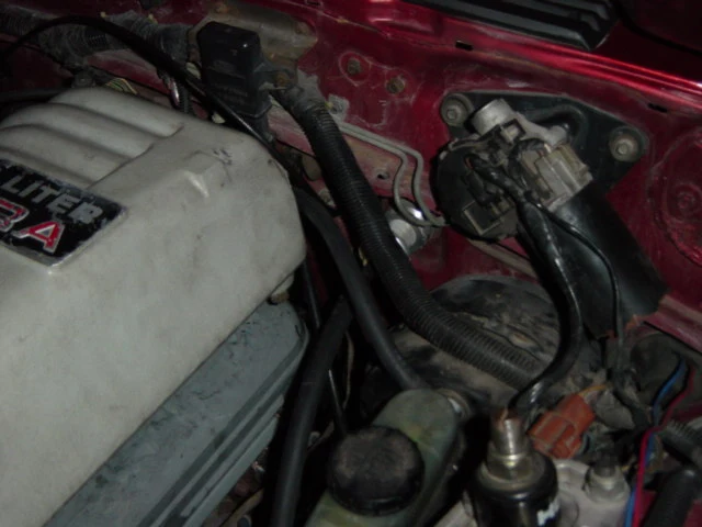

Here are some pics. Sorry it's so dirty right now. I just got the car and haven't pulled the motor yet.

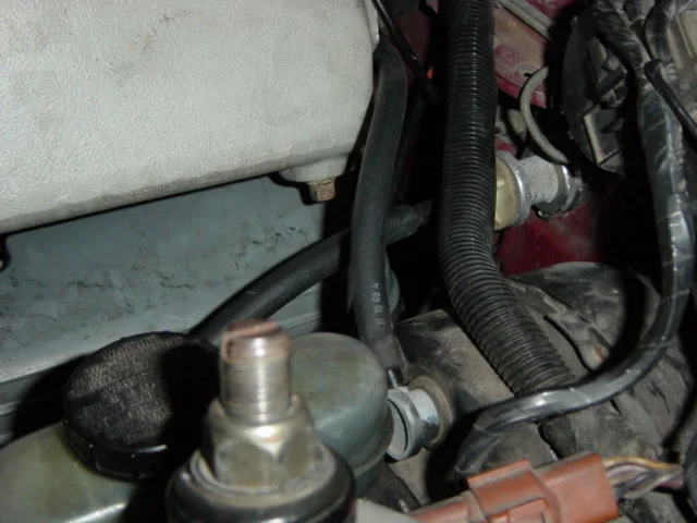

here's another one.
