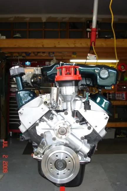

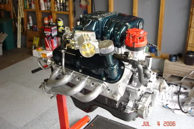

I have fox vc's on mine, just needed to angle the filler tube slightly. It worked without angling it, but I needed to remove my cold air intake every time I wanted to remove the oil filler cap.
