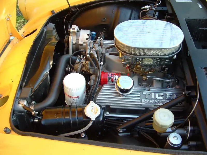

Anyway - On the way home from the exhaust shop today the motor started making little popping sounds - more like little back-fires through the carb. There was some stuttering too when applying more throttle. I also noticed a significant loss of power. ( when revving the engine it almost felt like a 4cyl ? ) The temp was in the low 80's.
Does this sound like it could be vapor-lock?
My fuel line is rubber hose & currently routed up along the bell-housing, behind the passenger side head, & into the carb. I also have a Holley red elec fuel pump rated at 7psi if that make any difference...
Thanks in advance.
If the fuel line is touching the motor/tranny ANYWHERE you have opened the door for vapor lock.

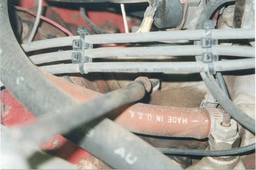

It's definately sort-of squished between the fire-wall & head. You can also see in pic #2 where the fuel line coming out of the "el cheapo" regulator is laying flat againsted the intake...
I'll try to reposition it.
Do you think from my description of how the motor is acting that what I am experiencing actually is vapor-lock?

It sounds like fuel starvation of some sort, being either vapour lock or fuel line restriction. Can you route the line along the seam where the rocker meets the floor and then up the fire wall?
Unfortunately, the answer is no.
The fire-wall is only as wide as the engine so trying to come up either side would put the fuel-line right beside the headers.
My only option is to try running it to the front of the motor & then up and over...
I've contemplated running the line through the interior & then through a gromet in the fire-wall but that would be kind of sketchy regarding safety & all that.

No, it sounds like your ignition is shorting out. Crossfire, melted wire somewhere, loose coil connection, coil shorting against engine block, broke the carbon contact while installing the cap... ? Fuel problems won't likely cause stuttering at light to zero load.
The best way to confirm vapor lock is with a fuel pressure gauge. You should install one after your regulator. You could probably find a T for your dual feed that has a gauge tap built-in.
Nice Tiger!!!!!!!:nice: :nice: A couple things I'd do that'll probably help. Separate the plug wires. Ditch the electric choke. The old gas in the tank might be a factor. What intake is that on it?

Oh, jees! I didn't even notice the wires. When they are run tightly parralell like that they will crossfire and the path of least resistance. That would usually be the shotest wire, or the wire with the best contact to any part of the engine.
By the way, my uncle had a '65 Tiger with a dealer replacement/upgrade Boss 302.
If you really like the zip tie look, try what I did:
1. Wrap one tie loosely around 4 wires
2. In between wires, wrap another tie around the main tie
3. snug up main tie, then tighten the in-betweenies
4. snip all excess
