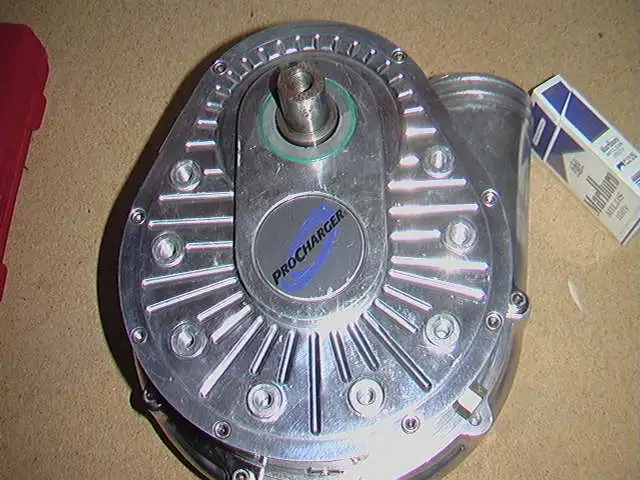

Well the P1SC is used on many applications, so depending on how the brackets are made and where the inlet and outlet need to be routed to, they actually have to turn the core of the SC so it lines up for your application as well as lubication and oil draining reasons. The one P1SC I have was clocked for a Toyota Tacoma (For testing purposes) I checked its history with Procharger. The "clocking" refers to the position of the Procharger emblem position, with the discharge nipple facing up.
Not sure I did the picture right.
Makes sense now.
