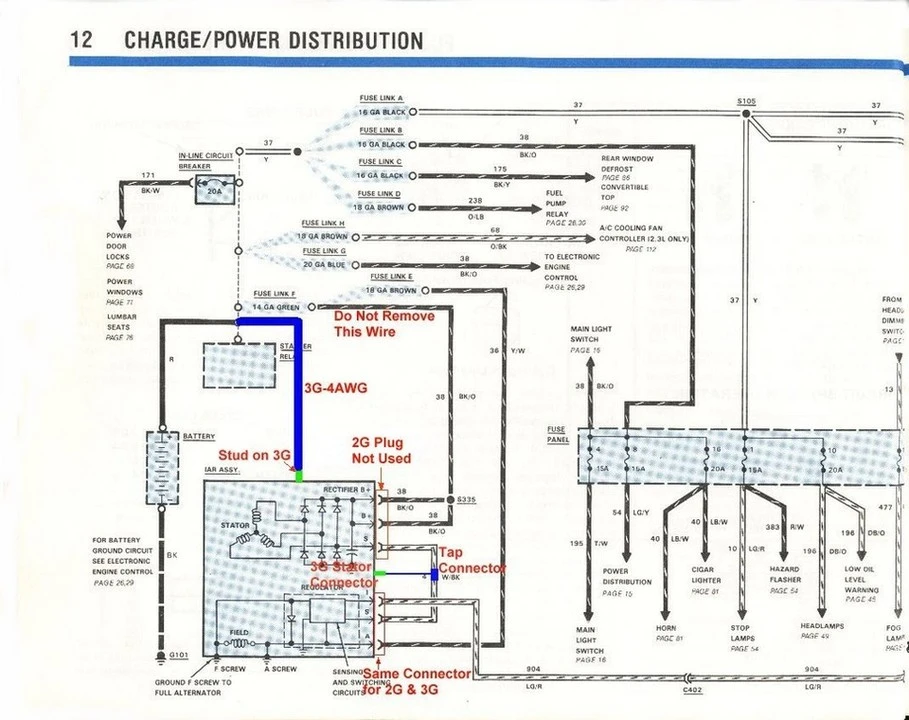

I can't for the life of me understand why you went with a standard 2G alt when your stock one bit it. The cost to upgrade to a 3G 95A-130A is negligible in comparison. I just received today my fully polished, completely refurbished upgrade 150A 3G unit. It cost me all of $135. The only thing I really need to upgrade with this alternator is the power and ground wires.

I think the wiring scares some folks, but your right it's a must have even if the 2G is still good and takes no real skills to install.

Hi, thanks for the info about aftermarket retailers. I wasn't aware of this upgrade and I was in a hurry to get the car driving again. So making modifications wasn't on the agenda. The only mod I thought I was making was upping the amps, which apparently you're telling me I didn't even do (good thing I didn't go for the 65) And Stangman is correct, I'm not very confident with my soldering abilities, so I wouldn't consider doing that upgrade on my own. That said, the next time I replace anything I'll do a more thorough inspection of what's available here.
