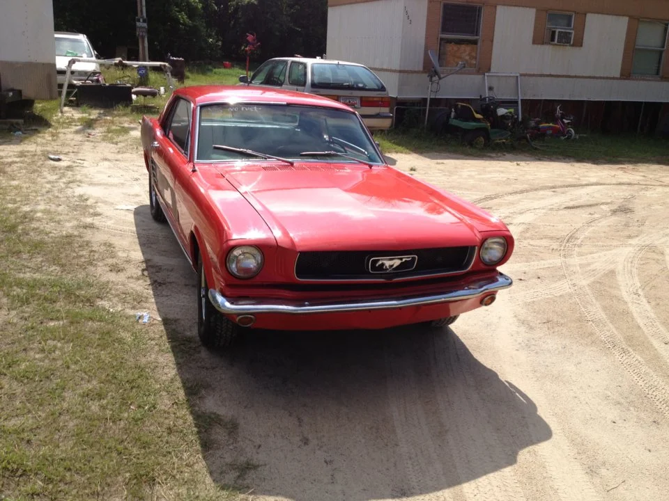

Was going to be a driver, but events prevented that but changed gears and now i want to make it blaze down the track and don't know the first thing about how to do it. Gotta start somewhere.

Since I know nothing except theory anything would put me ahead of where i am now. I guess to make it less aimless I would like to start at the start. I'll start with where I am. I have the mustang you see there it was for a friend that was suppose to be retiring from the NAVY after i got out so I got it and he was suppose to purchase it from me he backed out on the deal. Anyway it is a 289 but there is a lot of space in there. The body has no rust on it and the interior is solid just a worn spot in the driver seat. anyway I know that 289 can't get down the track so i guess I'd like to ask what should I do first?

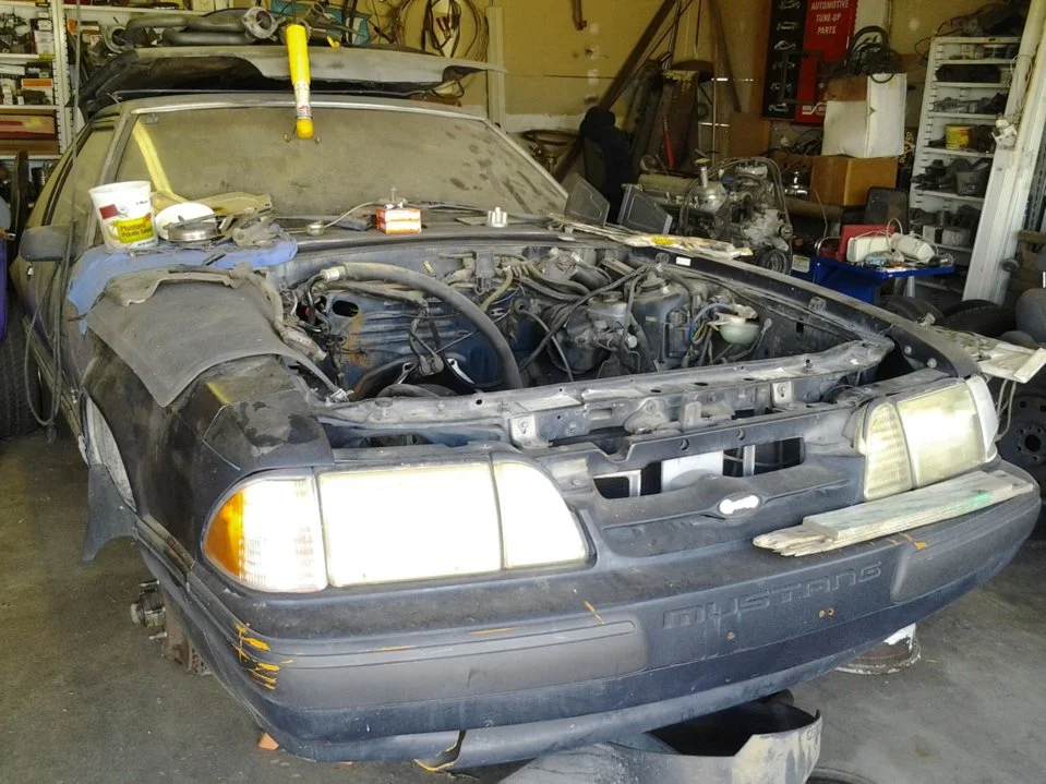

I'll trade you for my '88 hatchback, which is clean and rust - free (it lives in AZ)
The fox body is a much better drag race platform. It's lighter, has a lower center of gravity, much better brakes, and, you can put a 460 in it, without modifying the entire front structure of the car. I also happen to have a 460 and a c-6 automatic. I could assemble it all for you, or, I can deliver the "kit" to you. I have done the 5 lug swap on the front, and have all the parts for the rear 5 lug conversion.

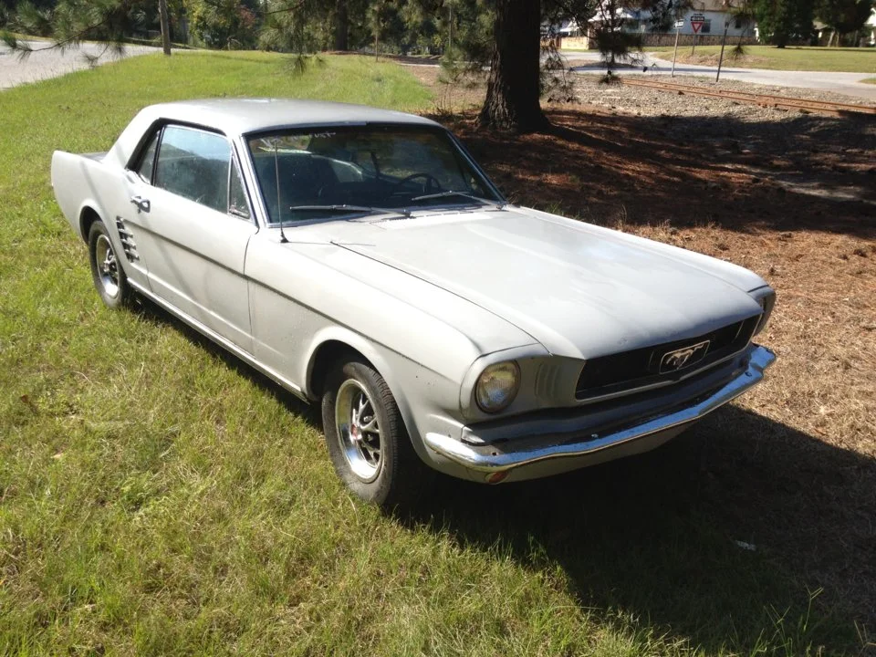

The car in the picture looks like mine but the door and stuff are gone

So someone blew your doors off, and hence the call for help? It all becomes clear.......;)
I would still trade you. The '88 makes a much better drag car. With the 460, it's capable of 11s without modification, and 9s with some engine work (heads, etc.) according to Hot Rod Magazine.

I was talking about your doors, that's yours on your profile pic right?
