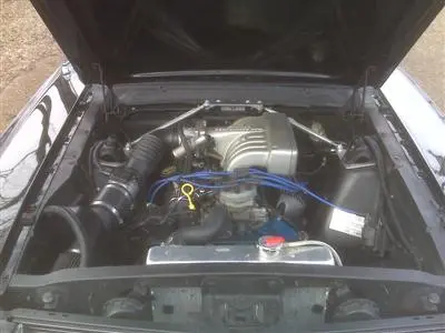

Feb 7, 2009
  • Feb 7, 2009
Engine bay pic as promised - taken with my phone so the quality sucks.
