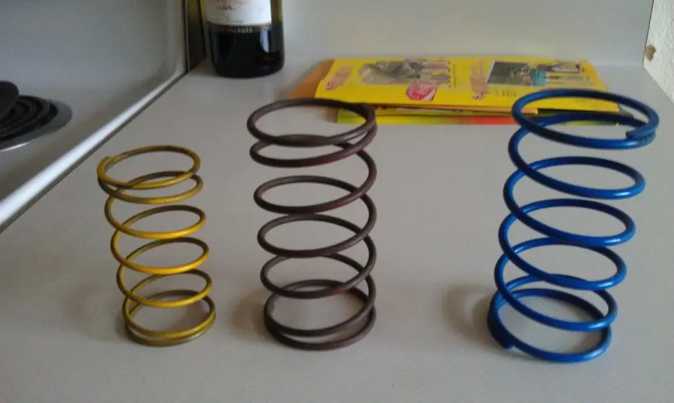

I have 4 diffrent springs,and i need to drop down to the lowerest spring i have for now.I noticed the coils on the springs are diffrent thickness or diameters.So the spring that is the smallest is the low PSI?So the yellow spring pictured here would be close to 5PSI

It looks like the yellow spring is smaller ID, usually that is the spring added inside on of the others to increase poundage.
Who's wastegate is it? Tial list all the springs on their site
My WG is whatever comes with the POS ON3 kit.......I am useing a hallman pro series manual boost controller.With it turned all the way down i see 9PSI on my autometer boost gauge.peace
