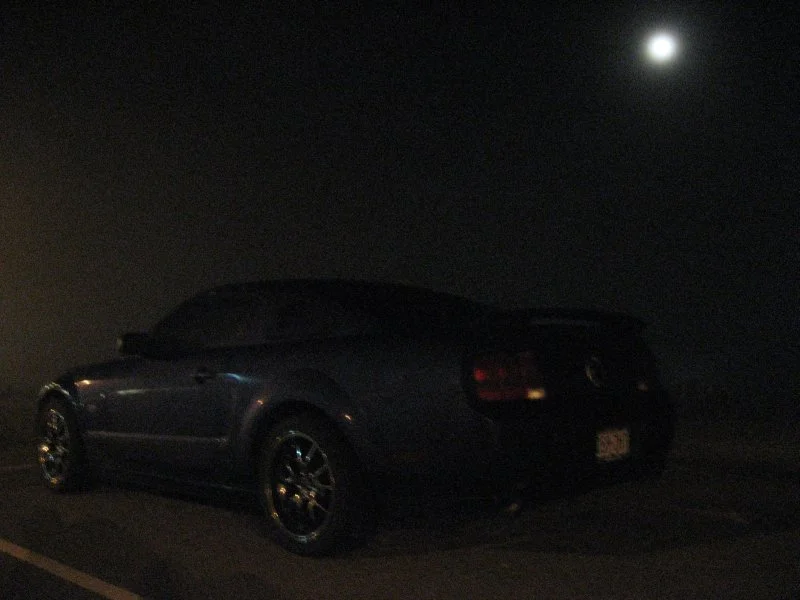

From the thread you had a link to is sounds like you changed the rear springs but not the front. Is that correct? How is the ride height? I was kind of thinking about doing that. I don't want to lower the front as I already have occasional scraping problems on the awesome streets here, but I wouldn't mind dropping the rear some as long as it doesn't look funky. Do you have any pics?
The car evens out. The ride is marginally stiffer and the pinion angle remains in spec. But this is only using the Roush rear springs. Overall I like it. I'll keep it like this as long as the car is a daily driver. Once i get something else for the commute I'll drop the front as well. Gives you options but other then that it is still an excellent choice.
Excuse the darkness in the pics but that's how the car sits I'll need to get better shots.

I didn't get a chance to weigh it but it I can tell you that it definitely is heavier then your panhard setup. The way I see it the LCA's and the Springs are light weight that offsets a little for the increase. Besides it's not a bad thing to weigh down the back end more considering the car is nose heavy that brings the weight distribution more closer to neutral.
