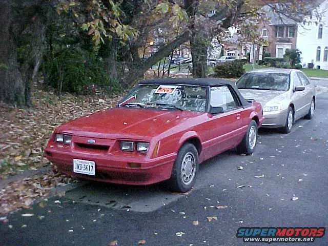

Meet my new '86.
It's a dead-stock 1986 'vert with a blowed up 3.8 and Maaco paint that I got to replace the 1991 Crown Vic that I spent a couple years with. Plopping the T5 in the Vic was an experience, but now I want to build something a little faster that can actually handle.

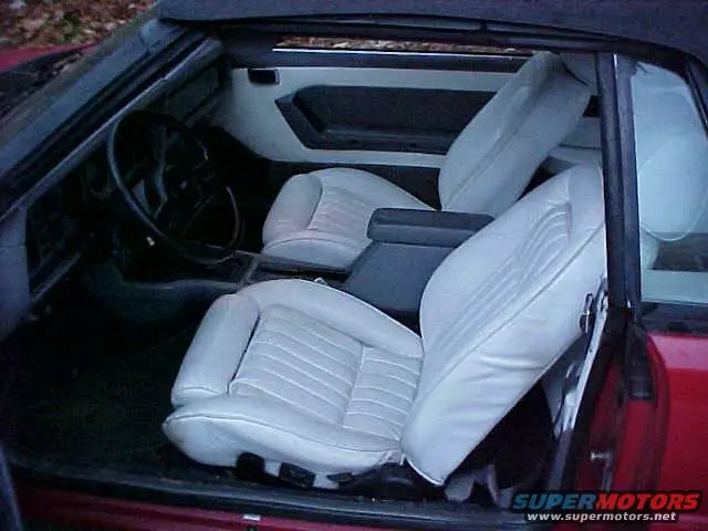

Dig on the interior. It was rehashed about 10 years ago but is getting to need it again.
I don't know if it's normal (I doubt it) but the center console of my car is covered with stitched leather.

-the stitched leather on your center console is custom
-your door panels are custom too, looks like 87+ armrests and a custom door panel
-seats are 87+
