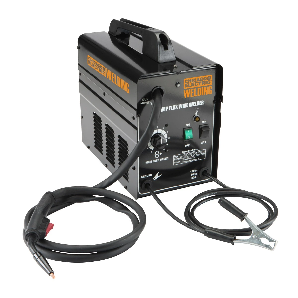

Recently I bought a Harbor Freight flux core 110 welder for small home projects-and it works surprisingly well,would be a cheap learning tool to get-
just don't weld body panels with flux core-when you move up to body panels/floor boards a gas mig is the way to go :)

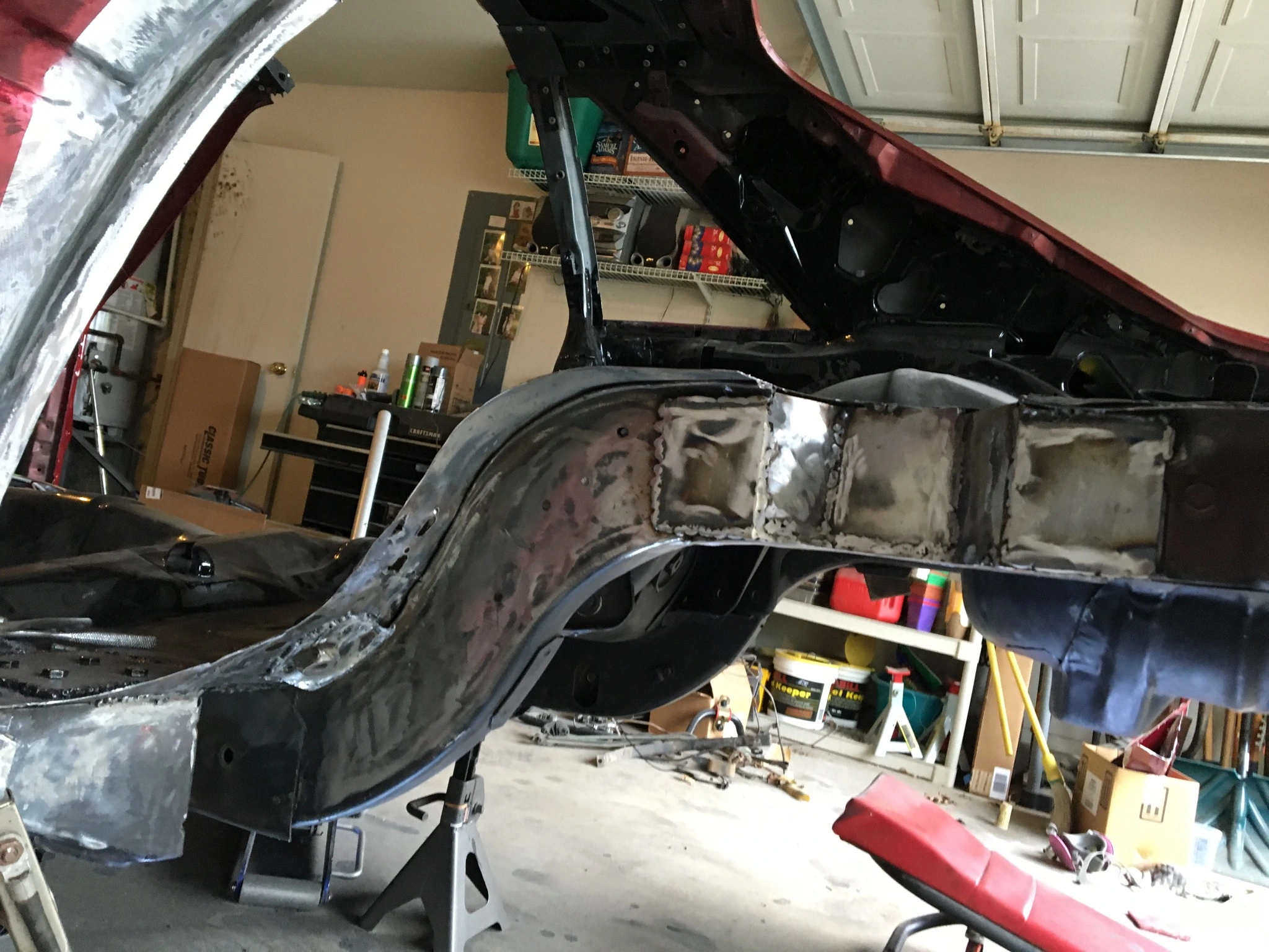

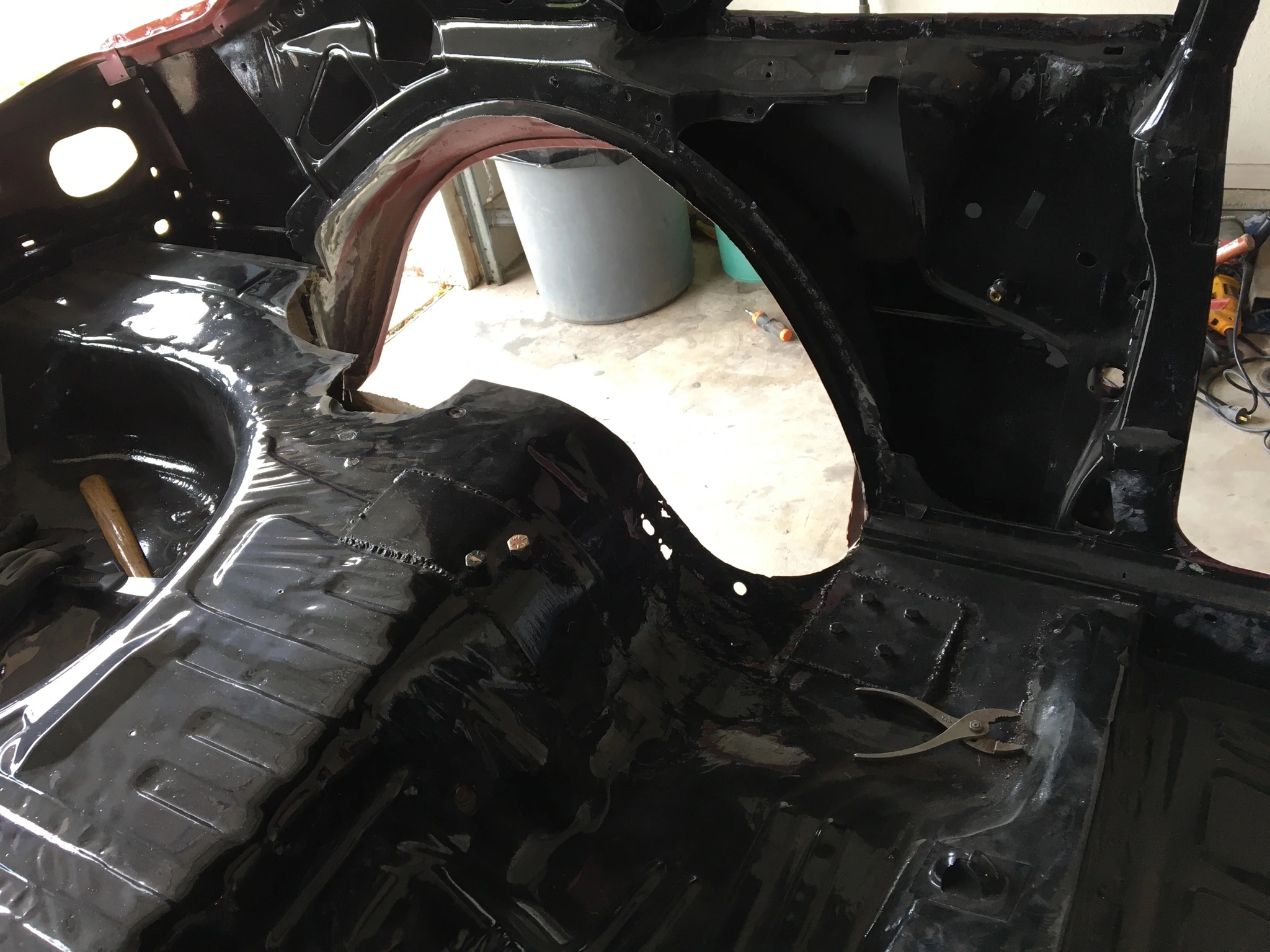

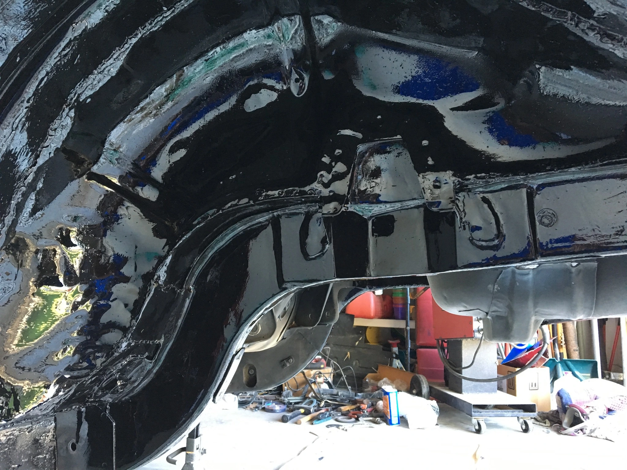

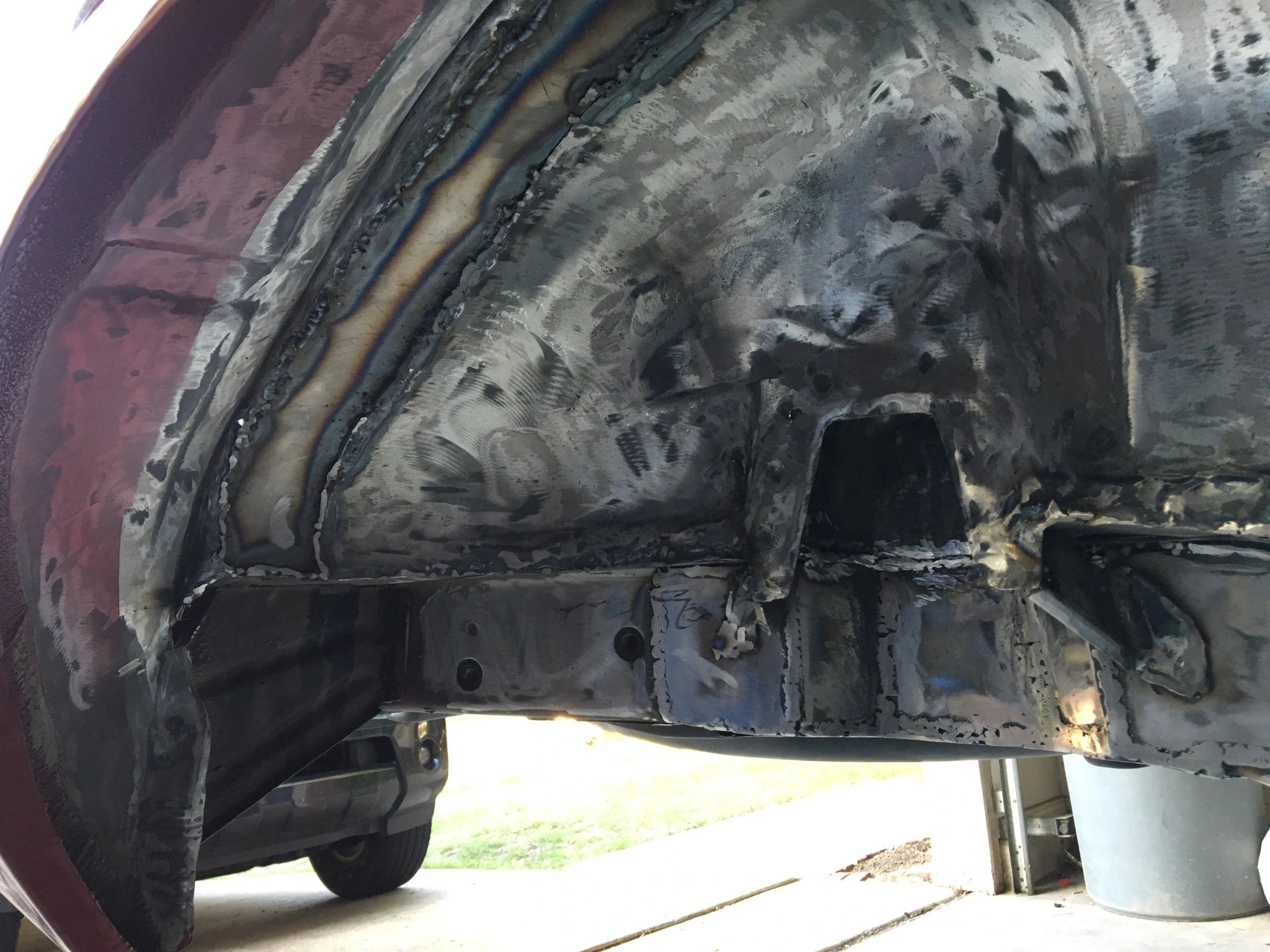

Throw up a pic of your wheel tubs Dave, they looked really good
As though this is anything to be proud of:
Things to notice, the welding won't get me into any magazines, But the rear end is so freaking solid that it amazed me. Just take your time, step by step and make sure the metal is bonded.
