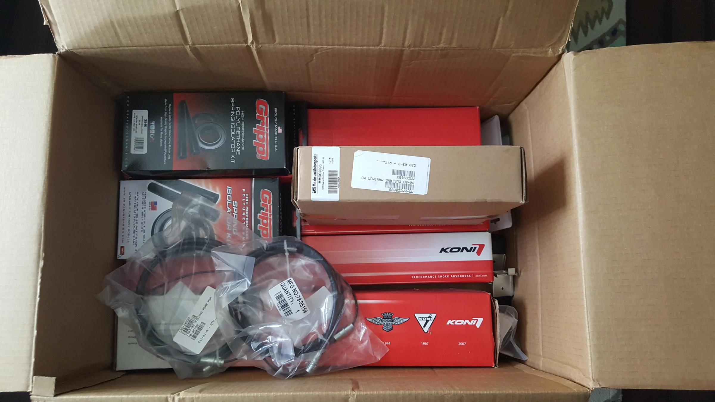

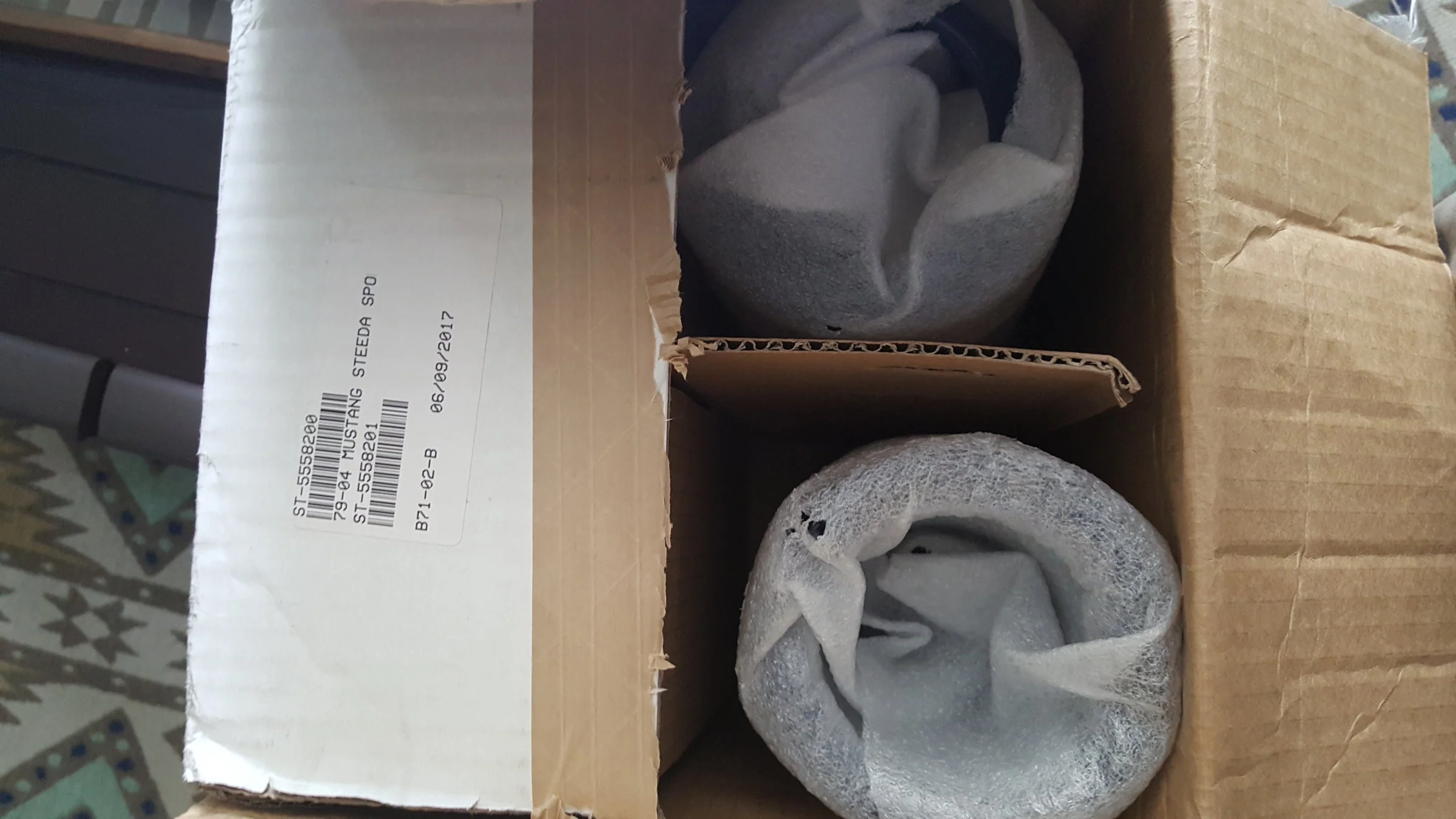

the time has come, where I have spent more time replacing parts than actually driving the car, so I might as well start a build thread to help myself document this. so far I've replaced every piece of weatherstrip (excluding hatch), door lock actuators (already need to replace passenger side again), replaced fuel tank/fill neck grommets, shorty headers, bbk catted H, flow master stainless exhaust, door pins, repaired leaking sunroof, repaired crappy radio install. in Lieu of this weekend's incident where the ball joint washer stripped off the top of the ball joint, I just ordered the moog lower control arms with ball joints, steeda lowering springs, bbk front and rear isolators, koni orange str.t shocks/struts. I'm hoping after I replace all of that, I can enjoy driving the rest of the summer before I do a top-end kit. possibly more. here are some photos of the new goodies. thanks everyone for their advice here. truly.

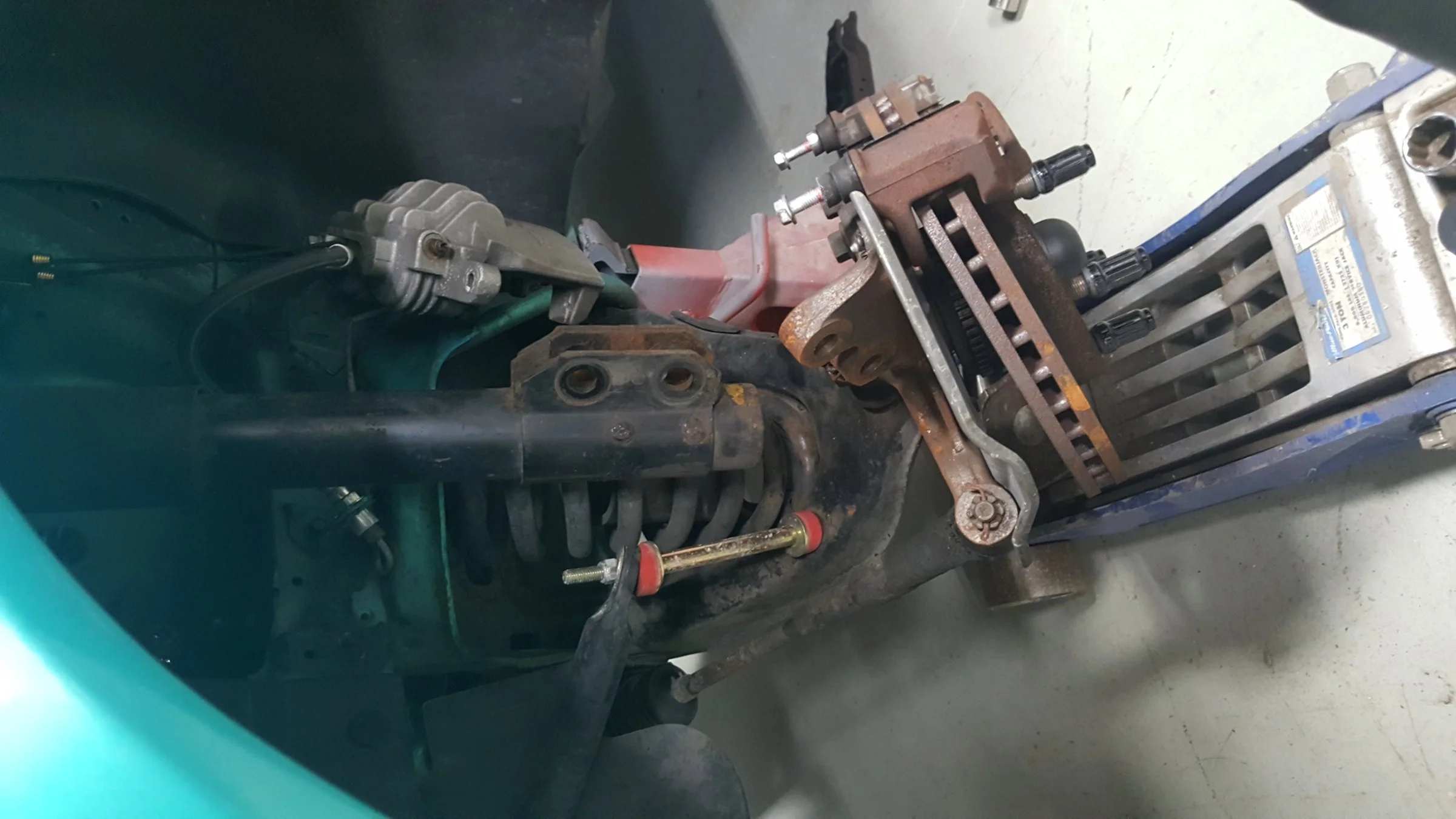

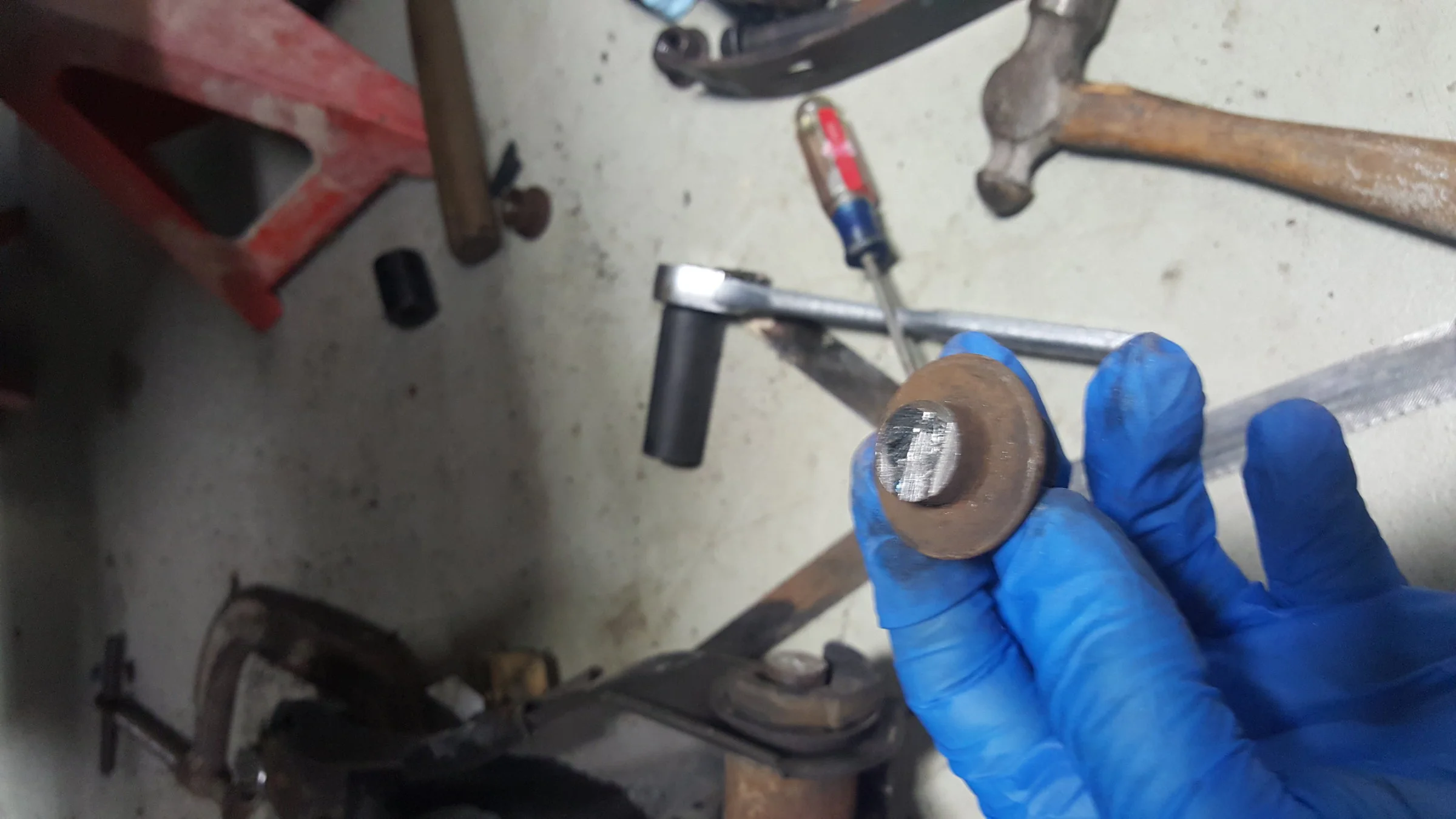

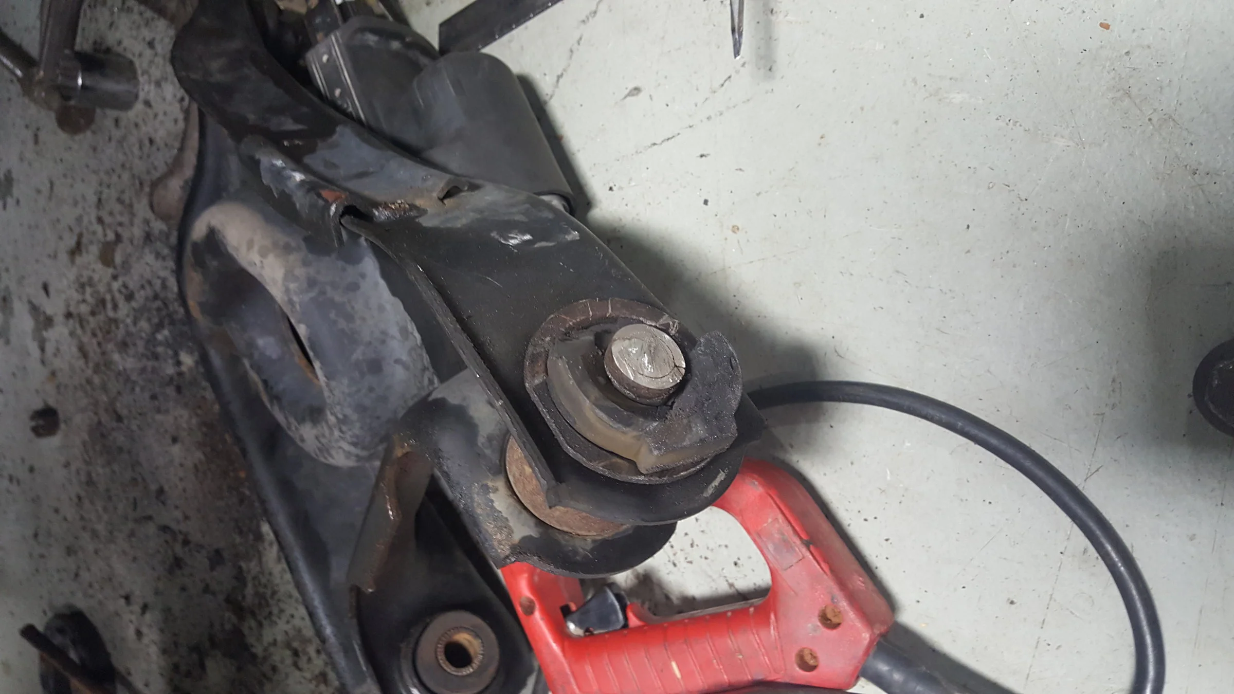

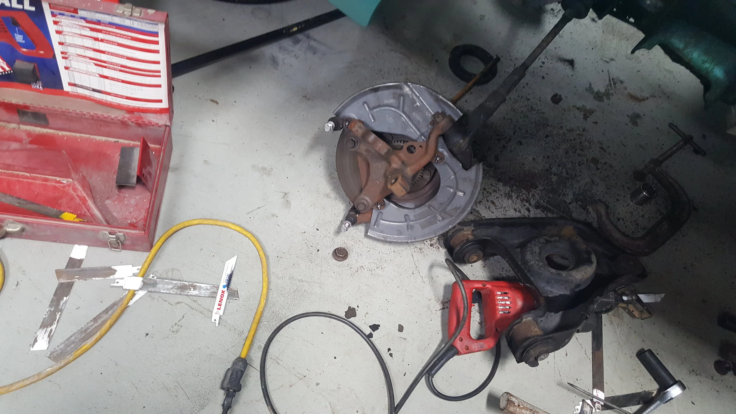

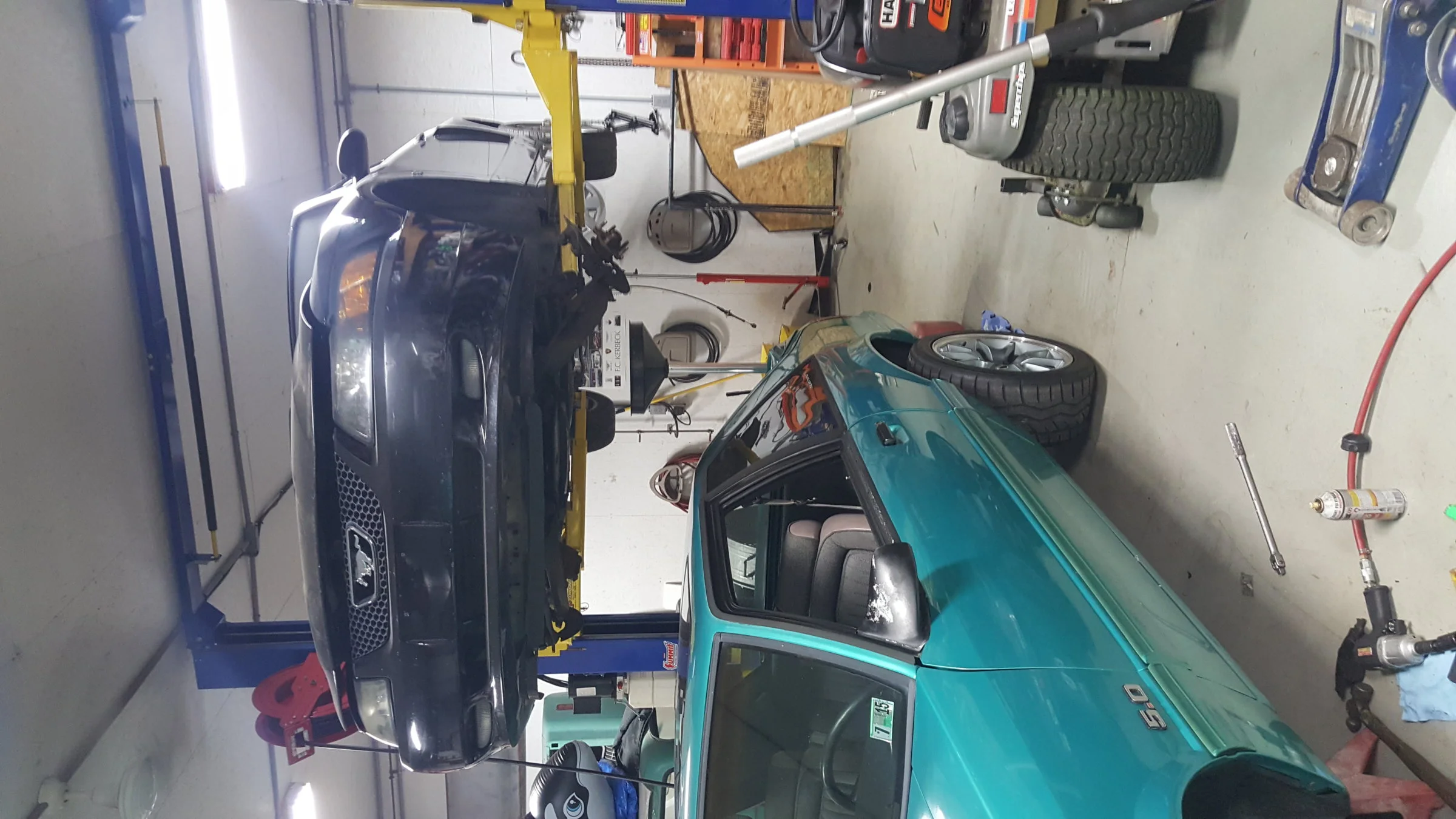

so tonight was fun. started tearing into the suspension at my buddies shop. figured out that the previous owner never installed washers on ball joints to balance out the 94-95 spindle differences for my 5 lug swap, and that's how the ball joints were damaged. ordered moog control arms with ball joints, and passenger side came off with a breeze. 1st bolt on driver side, no problem, last bolt on A-arm was completely seized... took a while to break it, but the sleeve/busing was keeping it from coming out. had to cut that hardened bolt.... it took us close to 2 hours to get that 1 bolt out. went through. couple sawzall blades too. haha. what a nightmare. so have to find an A-arm bolt ASAP. here are some photos. please note how previous owner installed sway bar links without the too bushing. wtf.
That sucks about that seized bolt. Sometimes little things like that turn a simple job into a huge headache. At least you were at your friends shop with all the right tools. Just go to a hardware store and get yourself a new grade 8 bolt. Make sure to put some anti-seize on the bolt before you install it. Did you order SN95 ball joints so you don't have to use washers?
unfortunately, I have to use washers. i didn't have access to a press, so i ordered moog lower control arms with the ball joints already in them. i just grabbed hardened washers, so hopefully I dont have any other issues.

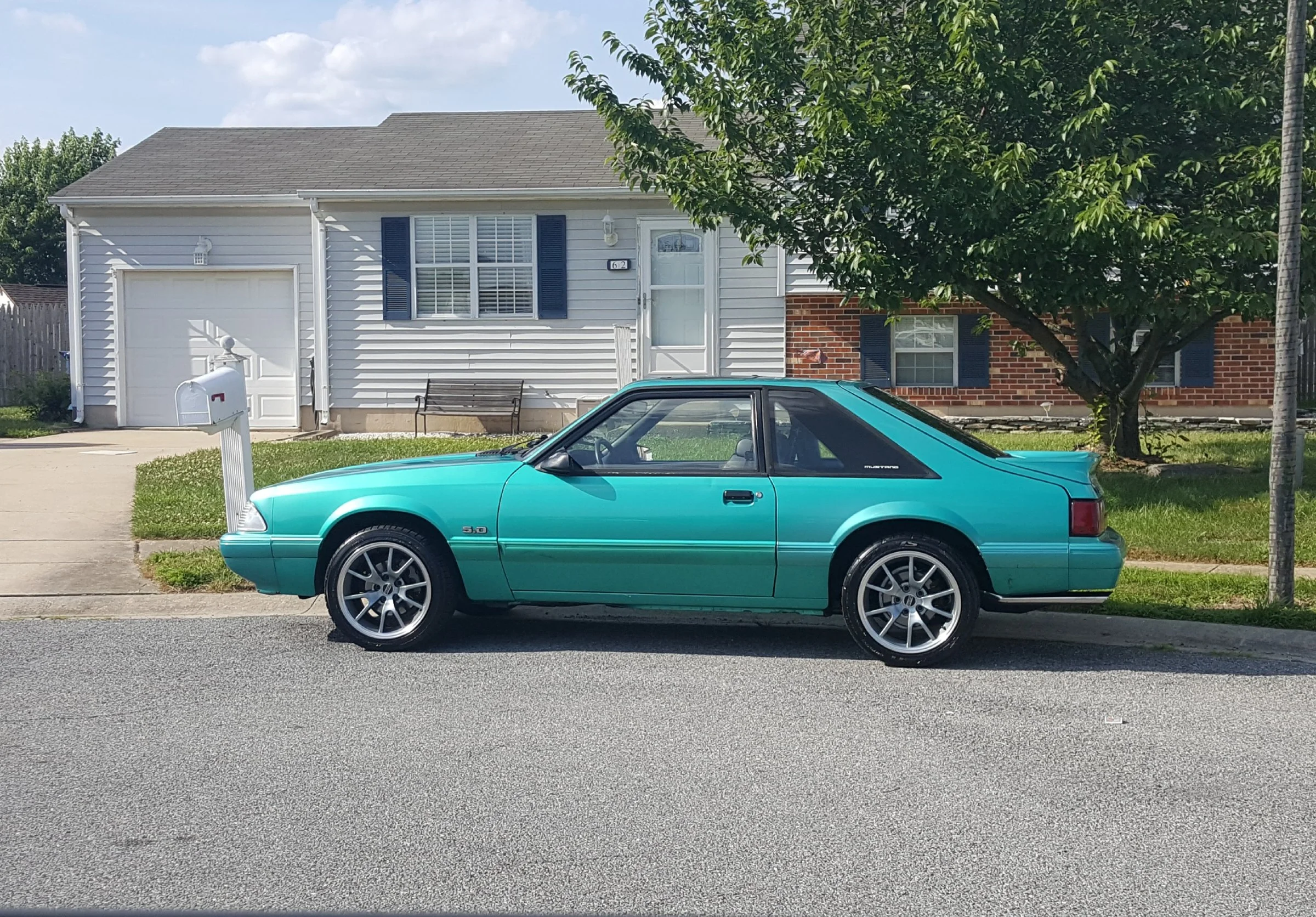

dropped the car off today for the alignment after doing the CC plates and everything else. man oh man, huge difference. I can actually drive this thing now, but I absolutely hate having any front turning radius due to these 17 x 9 wheels.... it's the worst. regardless, I'm looking forward to putting a ton of miles on this until my shop get built.
