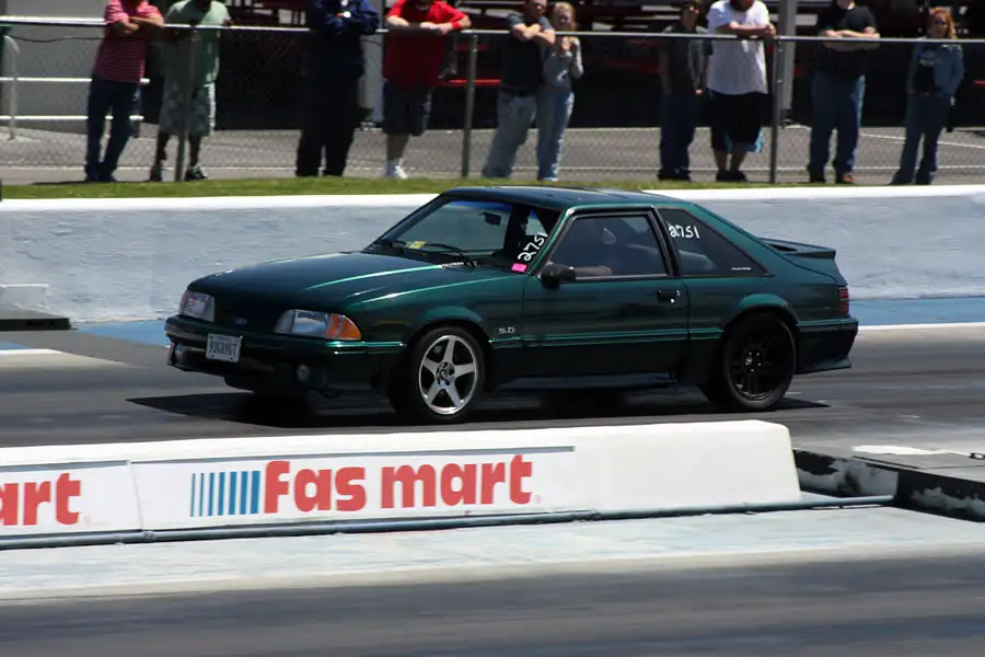

Anyways, had fun as always at the track. Best pass was a dismal 12.99 at 119.21 mph with a 2.29 60'.:lol: Considering the condition of the issues I'm pretty happy with the MPH and I know it has a lot more left in it. Hopefully after I pull the trans and install the new mods it'll be in the mid to low 11's at 122-124mph. It was spinning so bad it only went 89.xx mph in the 1/8th but still managed 119.21 by the 1320 mark.

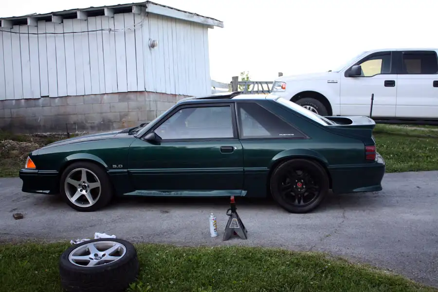

Here is a pic of the car with the new track wheels:

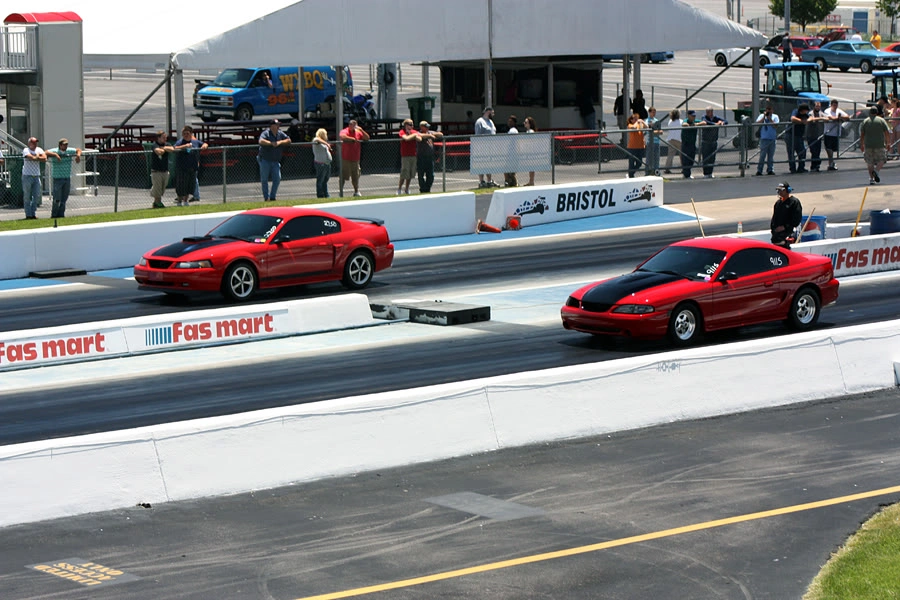

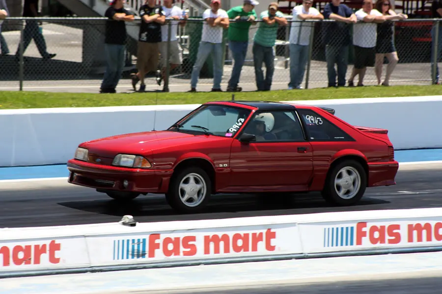

Pics of buddies cars at the track with me.
Probably the car that done the best out of all of us, 13.26(2.1x 60') at Bristol on a non sticky tire with mufflers/cai as only mods:
Ran 12.7x before it broke 4th gear, trapped either high 118 or low 119 on the pass before his 12.7x run:

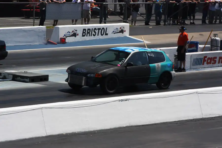

Before someone comments on the Honda looking like hell, you'll never guess that the owner is a painter as his profession, he just likes for people to look at the car and never think twice. It's a STOCK engine with a custom built turbo setup by The Shop(same place that done my tuning/intercooler piping/etc) and tuned by Scott at The Shop via an AEM and it makes well over 400hp to the wheels on 10-11psi, again...STOCK engine(H22).:nice: He's a fox fan too, so don't hate too bad. ;)

I gave it a shot on 17's and MT drag radials...they hooked much better than i thought they would, bogged it big time. Went 11.60's @ 124mph with them, then bolted on the slicks and ran the number in the sig. I want to run 10's with the 17's this year. :Track:
