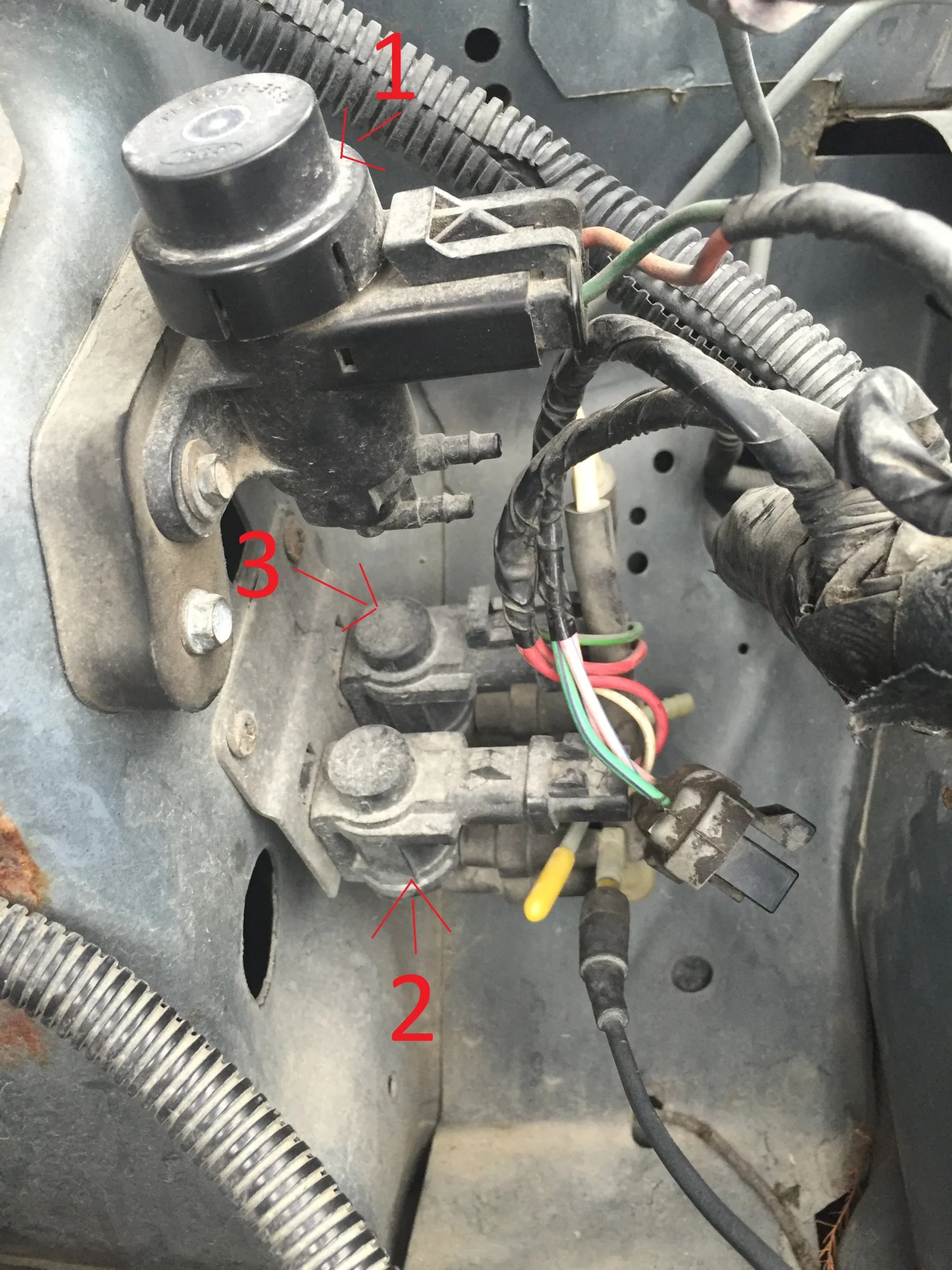

I am working on getting the vents in my 88 lx working again, as the previous owner deleted the A/C...but didn't bother hooking the vacuum lines back up. He just caped it at the tree and moved on. Can someone please help me identify the three items in the photo below please? It looks like the A/C port from the vacuum tree powers these three items past the vacuum check valve. I am trying to use the vacuum diagram, but I need help identifying what these are so I can figure out where to run the lines. Thanks all!!!

Those are for your EGR, smog pump and hoses, which I assume are no longer hooked up.

Correct...the EGR and all smog items have been deleted as well. Since its all gone, I wont bother messing with these then. Ill just get vacuum to the line that goes to the A/C. This helps. Thanks!
