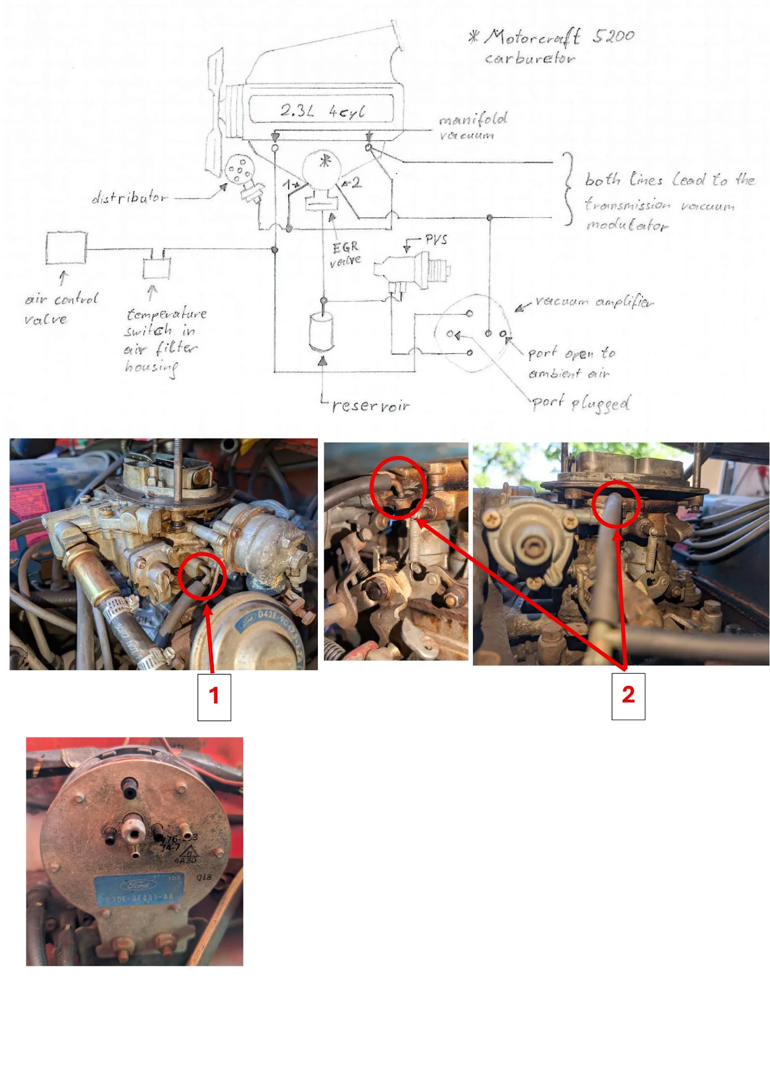

When I inspected the vacuum system, three facts confused me. Maybe somebody can explain this to me:
-) My vacuum reservoir is directly connected to the EGR valve and not to the vacuum amplifier or the vacuum line coming from the intake manifold.
-) The manifold vacuum is connected to the actuator under the distributor as well as to the carburator (Motorcraft 5200).
-) The second diaphragm of the transmission vacuum modulator is directly connected to another port of the carburator (same line that also goes to the vacuum amplifier)
Please see the attached diagram of my vacuum system - my description above migth be unclear. Maybe a previous owner messed these connections up??
Since I am not an expert on this matter, I would be very thankful if someone could give me advice, since I could not find diagrams that match my current vacuum system in either the 1978 Car Shop Manuals Vol 1-5 from Ford or the Mustang II Owners Workshop Manual from Haynes. Unfortunately I don't have the Shop Manuals from 74 available at the moment...
Additionally, does anyone have ideas on what I could check next, to hopefully fix the gear hunting issue?
Thanks in advance for sharing your expertise - any guidance to help me untangle this is hugely appreciated!

I mean visually the vacuum lines look fine and seem to hold the vacuum. But you might be right. Its worth a try and would be a simple fix. I am, however, unsure if all the vacuum connections are correct at the moment. As mentioned in my original post, some of the connections don't make sense to me (e.g. EGR valve and reservoir connected together...).
Do you, or does anybody by any chance have the Ford car shop manuals from 1974? I would really like to check if the vacuum system is hooked up correctly, or if a previous owner has changed stuff. Unfortunately my 78 shop manual isn't of great help since they've changed emissions related stuff in 75 and 76, I believe.

Since I was quite busy at work, I didn't have too much time to work on the car recently. The fact that the friend I share a car lift with occupied it a lot recently did not help either.
In hindsight, this was a lucky coincidence, since I looked at the kickdown rod again and embarrassingly found out that the return spring was missing. :doh: After fitting a new one, the gear hunting stopped. :banana:
Unfortunately, the shifting behavior still is not perfect, since the transmission holds second gear for a long time even when I only slightly press the gas pedal (switches to third gear at approx. 3500 rpm...). At 30mph, when I release the gas pedal, the car always shifts into 3rd (which I believe is correct). This leads me to believe that 2Blue2's theory with the diaphragm being stiff might be correct. I'll check that as soon as the car lift is free again. While I'm at it, I'll also check compression, as recommended by Mcmahst.
