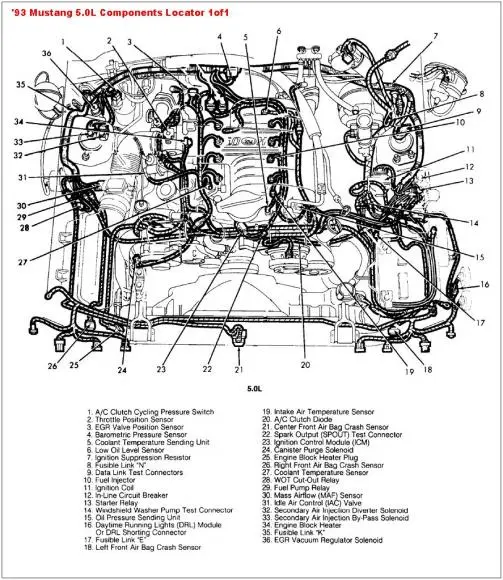

Thanks for the info, I will be pulling the parts out on Monday myself. As I traced the engine wire harness that comes out of my car through the firewall. It connects to two main connectors that seem to go inside the car on the drivers side. Here is a diagram I found hope it helps
thats it man. just make sure you pull it from a 88,89 or 90 mass air car.
man i went throught this a while back and for the life of me i cant remember the details. i just even searched my previous threads and couldnt find anything.
the 88,89 cars had no air bag and dual dash connectors (grey and black) the 90 had the same dual dash connectors and air bag provisions. in you case just dont use te air bag hook ups, well obvioulsy you cant and the 91-93's had the own stlye. they had a single brown dash connector.
i got screwed on this while doing a v8 swap on my car.
but you should be good pulling it from a 90.
