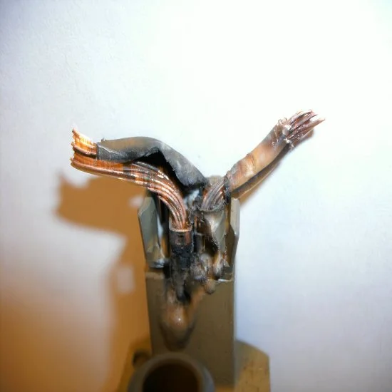

Ok so i was leaving autozone and when i turned the key to start the car it seemed like it was going to start when it stopped and then there was two really really loud sounds that came from what seemed to be the gas tank, it sounded like if someone took a hammer to a piece of metal and banged it twice, what was this sound should i be worried???
2003 GT Mustang 4.6 Fuel Pump Problem
I recently replaced my son's 2003 GT Mustang 4.6 fuel pump. The picture provided here is the actual fuel pump which I removed from his fuel pump module which is located inside the gas tank. From what you are saying, it sounds like your fuel pump burnt out just like the one in the picture. Click on the picture to make it larger. I believe there are two reasons for his fuel pump to burn out like this. I have a link on this subject elsewhere in this forum. If you are interested in hearing what I believe contributed to this problem, let me know. Good luck, Tommy.

I am defenetly interested in knowing why this happened since i do believe that my pump is no good it has been acting up lately and i will deffenetly replace it and i dont want it to happen again

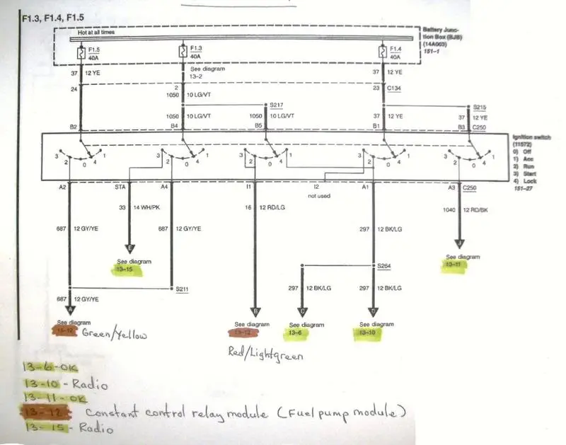

Ok, as I said I believe there are two reasons why my son's fuel pump burnt out. Reason-1: His gas gauge was not giving him accurate fuel level readings. When ever his gas gauge would read 1/4 tank, his engine would act up, die out. So, with a 1/4 tank reading, he was actually at an empty tank which he did not realize. Without gas in the tank, your fuel pump will over heat, and over a matter of time, burn out, because there is no gas in the tank to cool off your pump. Reason-2: If you have installed an after market radio, deck player, video player, amps etc. You need to check to see where the 12 volt feed was taken from. The diagram below is of the ignition switch for the 2003 GT Mustang. If you look at the diagram you will notice that there are 6 circuits that the switch supports. I have high-lited 2 of the 6 circuits in red, the other 4 in green. You need to make sure that any of the items I mentioned above is not tied into the red color circuits. Specifically the two 13-12 circuits. The reason is, your Constant Control Relay Module, which supports your Fuel Pump Relay, is tied into these two red circuits. Notice where the Ford Motor Company has their radio tied into. They have it tied into the 13-10 and 13-15 circuits. So, if any of those items I mentioned above is tied into the two red circuits, it will deprive your fuel pump circuit of the voltage it needs to operate properly, again, causing the fuel pump to overheat and burn up. Hope this helps. Let me know what you find. I'm very interested in your findings. Hope this helps. Good luck, Tommy.
