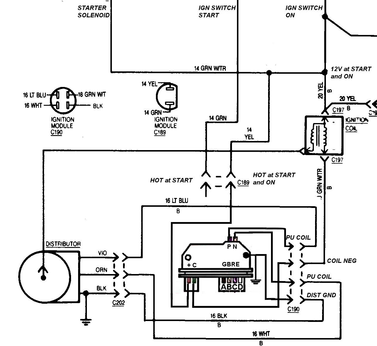

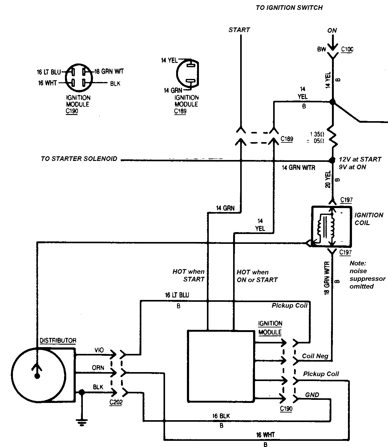

65ShelbyClone,
1.) At this point I am not sure to hook it up to a GM 4-pin HEI module or use Duraspark Module. I can the Blue Grommet Duraspark Module for about $20 - same price as HEI module.
2.) As I understand it, the Duraspark does have timing retart for easy starting. Correct?
3.) Is the GM 4-pin HEI module offer better reliability?
4.) If do get the Duraspark, would the Mustang GT 5-speed Duraspark Module the one I need?
1.) I'm not sure what you want to do either. :shrug: Personally, I used a four-pin HEI module because it was cheap and convenient. If you can get the right Duraspark parts for a comparable price, I think that would be a better way to go. The Duraspark distributor will plug into the Duraspark harness; no cutting necessary as with mine.
2.) Yes, it does. Nice, but not really necessary with 9:1 compression street engines though. None of the 11:1 horsepower war engines had any kind of cranking retard that I'm aware of.
3.) I highly doubt one is more durable than the other. It's easier and cheaper to keep a spare HEI module in the car, which is what I'm doing until the EFI swap happens. Then if the coil driver pops in my ECU, I'm just SOL and have to get towed. :confused:
4.) I suppose. I want to point out that I haven't used a Duraspark box. Everything you need to know about hooking up either one in this thread.

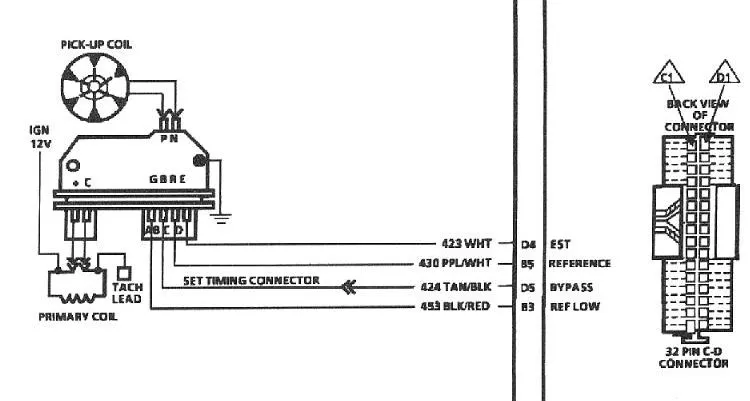

Before I bought my Ford Falcon, I had a 1977 Olds Omega (Chevy Nova) which had a Carb setup. At one time, I was going to swap to TBI setup. For this I pulled a wireharness, computer, distributor, coil and all from a mid 80's chevy truck.
I found a link below and realized that I could use the 8-pin HEI that is in the TBI distributor which I have already along with the coil with my Duraspark Distributor. I am going to take apart the TBI distributor and see which 8 pin HEI module I have.
http://tc.wagoneer.org/2012/08/gm-tbi-ignition-wiring.html
Going to try to use everthing that I have already first !
