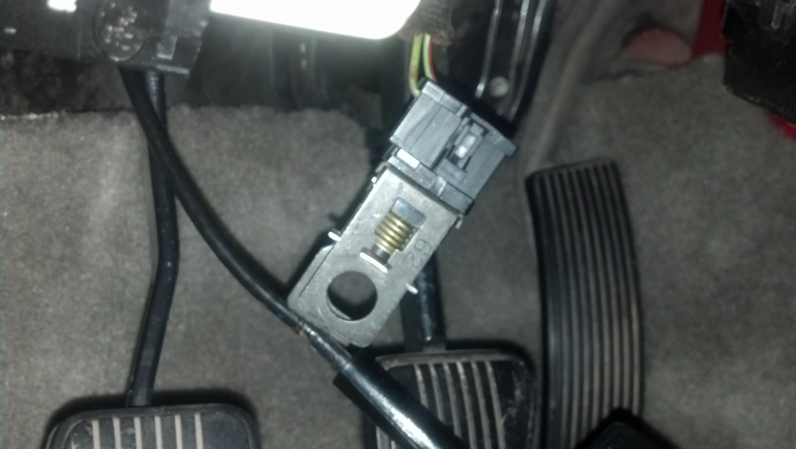

Sorry if I'm flooding the forum with questions here lately, but trying to finish this build up. I've got this connector under the dash flopping around, and I don't remember where it goes. I'm just praying the dash isn't coming back out. Anyone recognize this piece? I pulled the inside out well over a year ago and am currently stumped. Thanks.
If you look up under there where the pedal assembly is the brake pedal on the end has a red or green can't remember the color cotter pin and a washer then that switch then another washer if no washers are present put washers in there it needs to be tight in there
