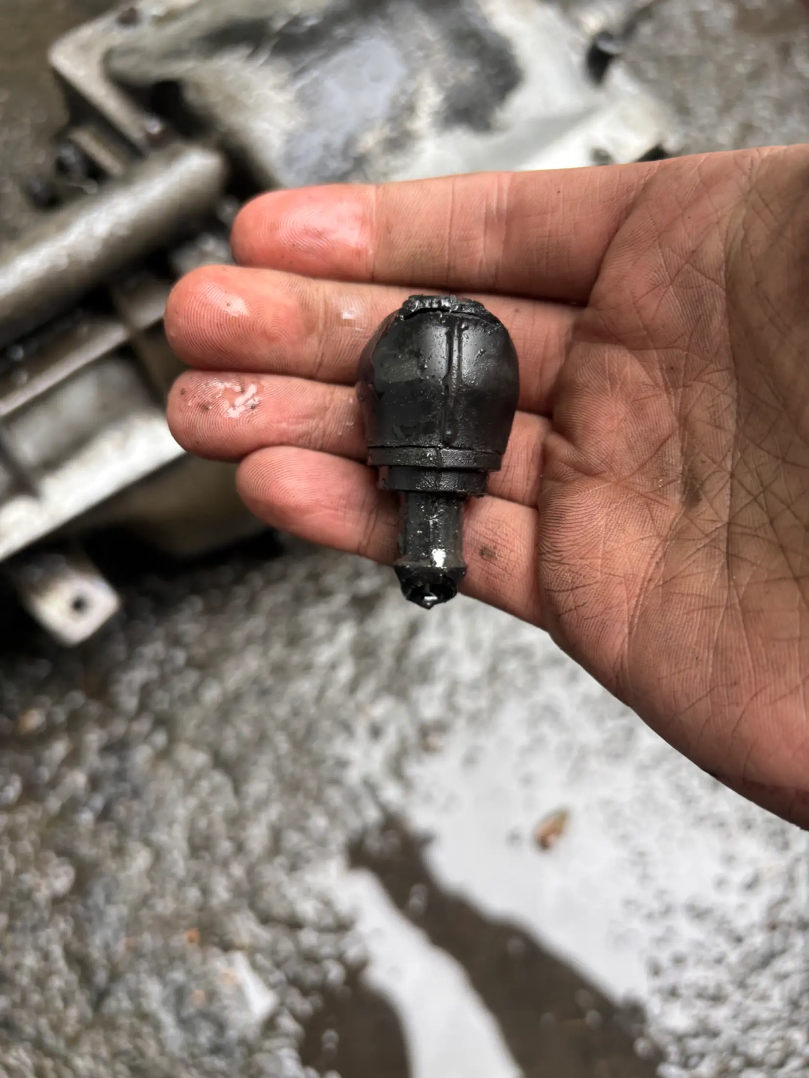

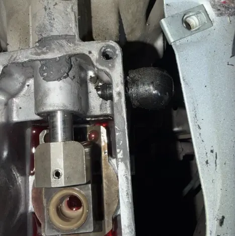

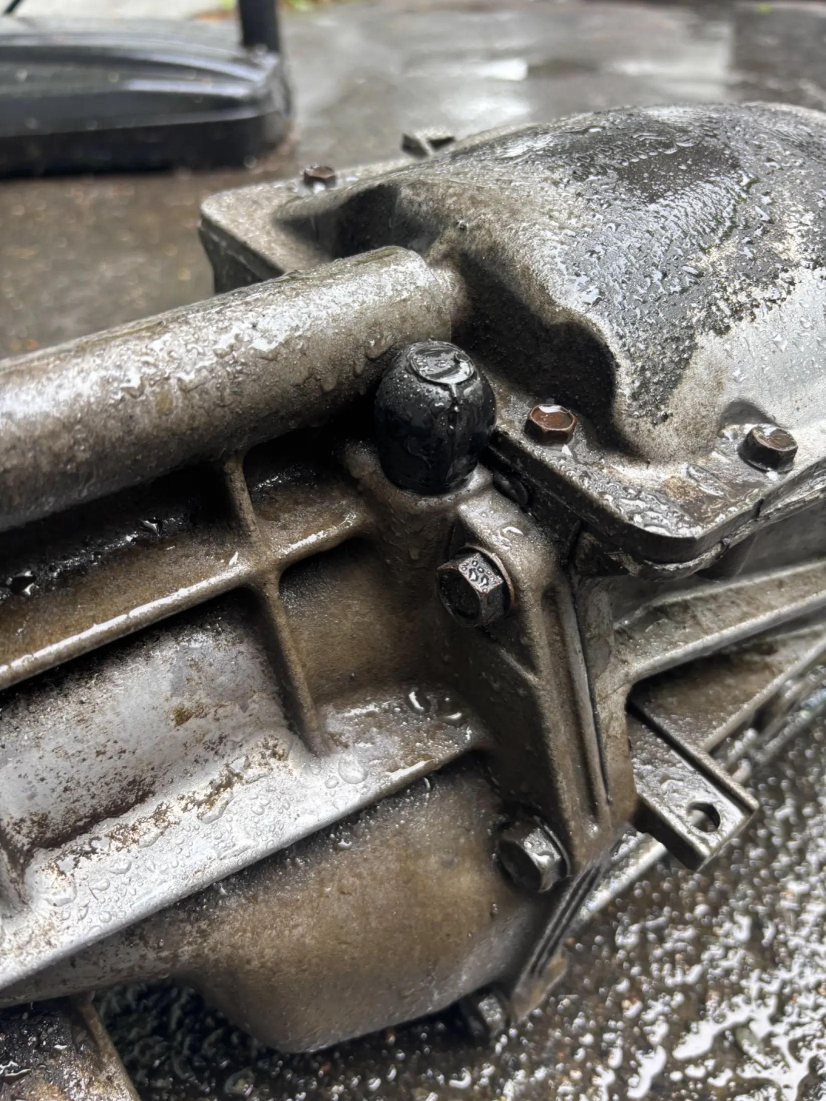

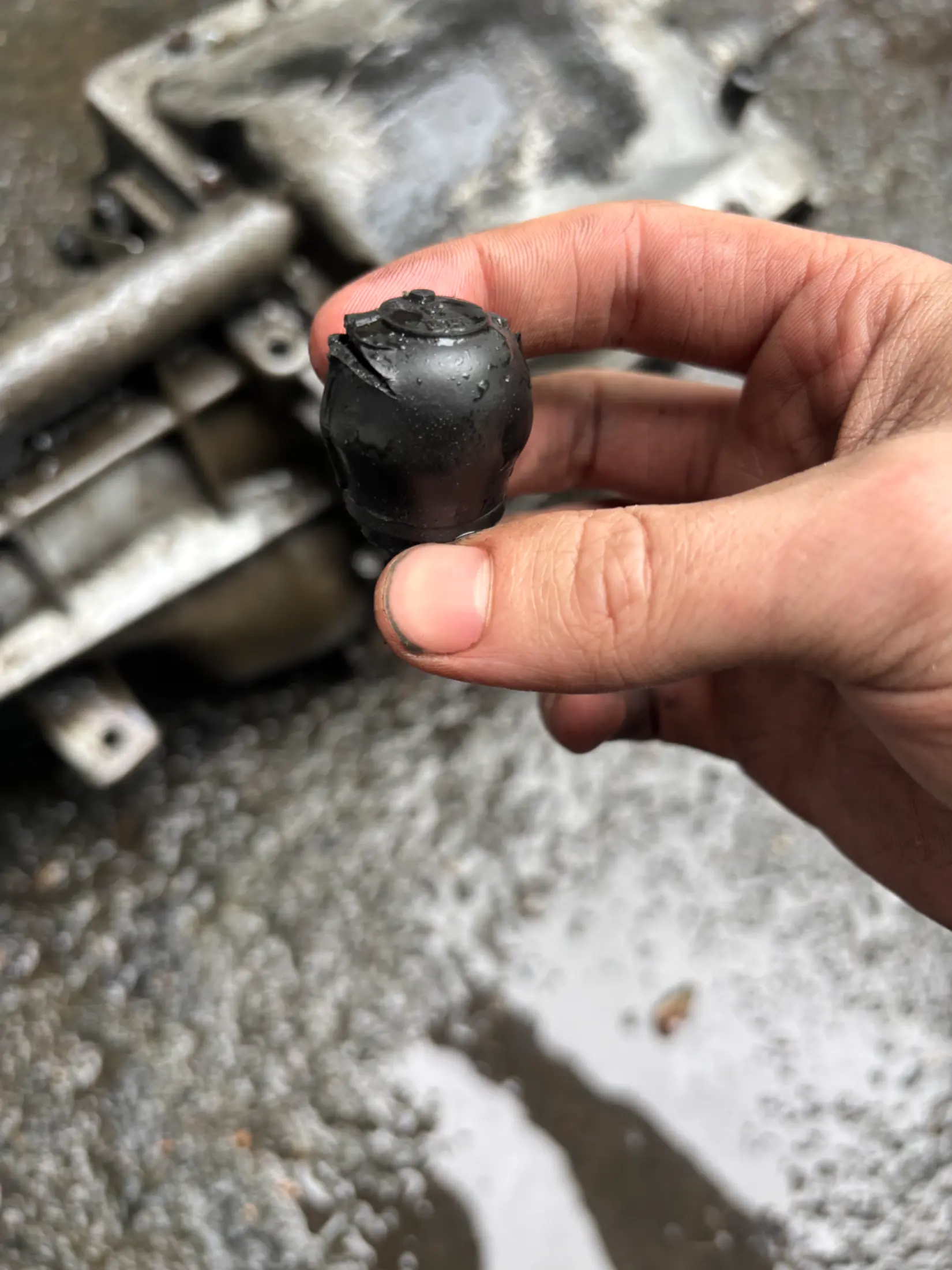

J jspaint97 New Member May 24, 2026 1 0 1 Vermont May 24, 2026 #1 May 24, 2026 #1 Redoing the seal on our t50d transmission, and noticed this part, is it supposed to have the cut in it because it is some kind of vent, or is it not supposed to have the cut? Attachments IMG_3691.webp 105.2 KB · Views: 49 IMG_3690.webp 127.5 KB · Views: 47 IMG_3689.webp 301.9 KB · Views: 57
Mustang5L5 That is…until I whipped out my Bissell Mod Dude Feb 18, 2001 43,361 18,107 224 Massachusetts May 26, 2026 #2 May 26, 2026 #2 I don't think that's an intentional cut. Looks like damage/dry rot. It is a vent as you said however. F6ZZ-7034-A F6ZZ7034A Genuine Ford Part Ford part # F6ZZ-7034-A F6ZZ7034A, Base part # 7034 at FordPartsGiant.com. Wholesale-priced and fast-delivered Ford parts Vent Valve Assembly. www.fordpartsgiant.com Discontunued part however. This one is specific to 96+ T5's but you can likely find an older Fox style vent to use as well It's also used in the T-45 here Last edited: May 26, 2026
