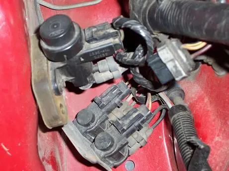

airbag New Member Aug 16, 2005 49 0 0 hebron, indiana Dec 8, 2006 #1 Dec 8, 2006 #1 This is located behind the passanger strut tower. can i delete these to clean up the engine bay, or do i need these. this is on a non-emission car. thanks nate Attachments 100_1149.webp 22.4 KB · Views: 134
modusmortis Member Aug 3, 2006 54 0 6 Dec 8, 2006 #2 Dec 8, 2006 #2 the big one with the cap is the egr solenoid. the smaller two are the thermactor air bypass and thermactor air diverter.
U uedlose Founding Member Jan 24, 2001 635 0 17 Charles Town WV. Dec 9, 2006 #3 Dec 9, 2006 #3 take them off if you are not running emissions.
